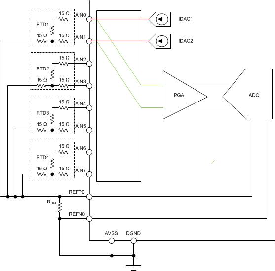

  • All,
    I just happened to find this thread today about using four 3-wire RTDs.
    There is a way to measure four 3-wire RTDs with the ADS1248. Included below is a diagram:
    It is very important to note that this configuration does not allow for input filtering. Any series resistance mismatch (like input filtering resistors will give large errors). There are 15Ω resistors shown to represent the wire resistances.
    If you don't need the filter resistors, then this can be done. However, if you do need filter resistors, then I would use your current schematic.
