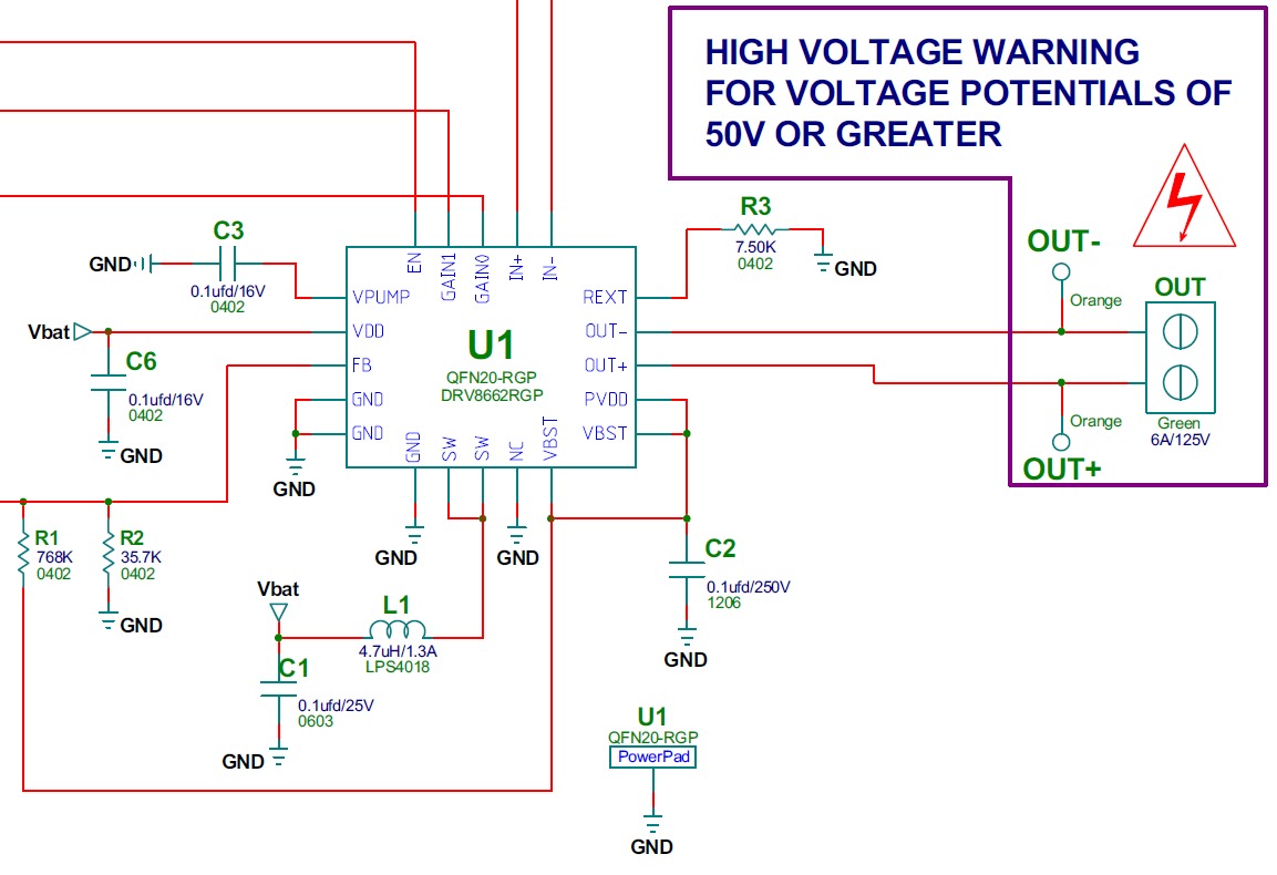

I would like to use the DRV8662 Piezo Haptic Driver in my bachelor thesis and I need help with the  output. I have the DRV8662 chip itself and the DRV8662EVM evaluation board. With the chip I build my own evaluation board with the same schematic around the chip than the DRV8662EVM except for the input. On both boards I am using a simple low pass filter on IN+ and IN- is connected to GND over a 100nf capacitor. The cut-off frequency is around 2600Hz. All the gain pins on both boards are LOW.
If I connect a waveform generator with a simple sine wave to both the boards the DRV8662EVM gives me an output signal but my own board does not.
I am guessing that there is something wrong with the input but I can't discover what it is because the external components are exactly the same on both boards.

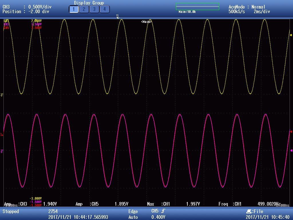

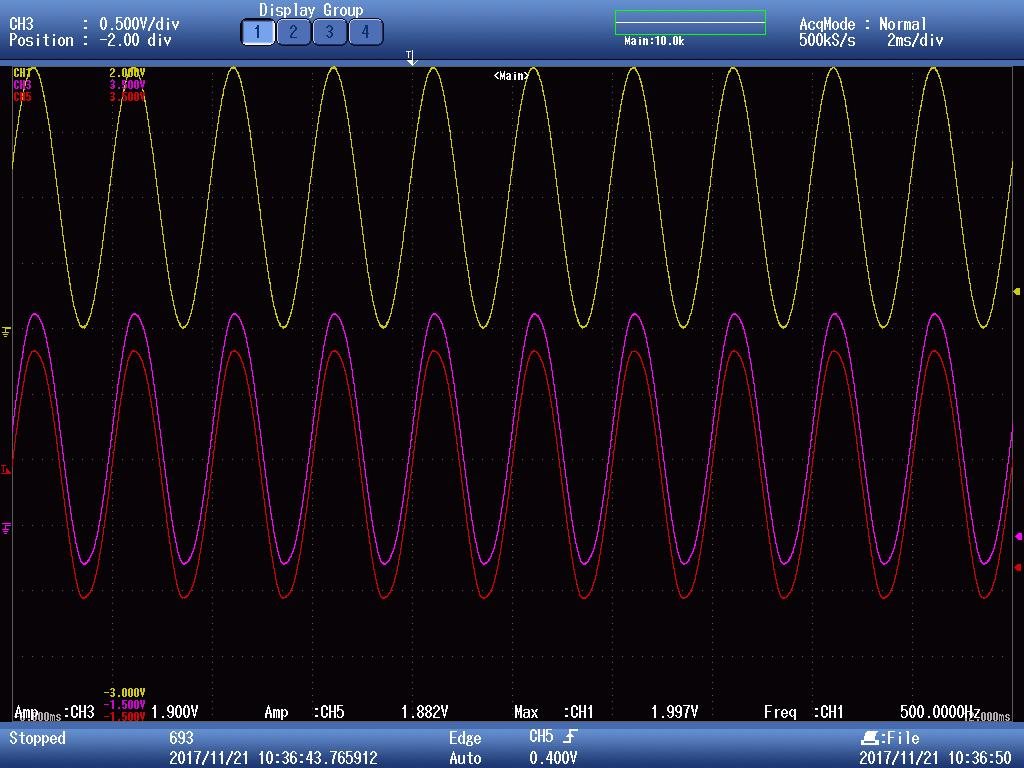

If I measure the differential input on both boards I gets this result on the scope:
CH1 is the input signal directly measured at the waveform generator. this signal goes to the low pass filters of both the boards. (later on I am planing on using a PWM signal)
CH5 (red) is the input measured directly at the input pins form the DRV8662 of the  DRV8662EVM.
CH3 (purple) is the input measured directly at the input pins form the DRV8662 of my board.
Even If I disconnect the power but keep the sine signal turned on at both boards I get different signals at the two boards which are shown in the next picture:
labels are the same.
But it can't be the low pass filter, because if I disconnect both DRV8662 chips from the low pass filter I get this result
CH3 and CH5 are the identical.

    Is the EN pin high? When the EN pin transitions from low to high, the amplifier turns on.
    If that is not the issue, then it would be helpful to see your schematic to verify the necessary components.
    sorry for the late reply. Email accidently went into the SPAM folder.
    The EN pin is high and I also get boost voltage and vpump.
    The schematic ist the same then the one for the evaluation board.
    Except EN goes to VBAT and Gain0 and Gain1 to GND.
    On In+ and In- I am using a different input filter.

  • There are some layout guidelines listed in the datasheet:
    11.1 Layout Guidelines
    • To achieve optimum device performance, use of the thermal footprint outlined by this datasheet is recommended. See land pattern diagram for exact dimensions. The DRV8662 power pad must be soldered directly to the thermal pad on the printed circuit board. The printed circuit board thermal pad should be connected to the ground net with thermal vias to any existing backside/internal copper ground planes. Connection to a ground plane on the top layer near the corners of the device is also recommended.
    • Another key layout consideration is to keep the boost programming resistors (R1 and R2) as close as possible to the FB pin of the DRV8662. Care should be taken to avoid getting the FB trace near the SW trace.
    It is strange that the chip is behaving in this manner. Even with an analog input, it is important to have the AC coupling capacitors in place (0.1 uF) at the input. It may be helpful to ensure that none of the pins are shorted together by probing for continuity. If all else fails, it is possible that the chip was damaged and is not operating correctly, and I would recommend trying again with a new chip.
