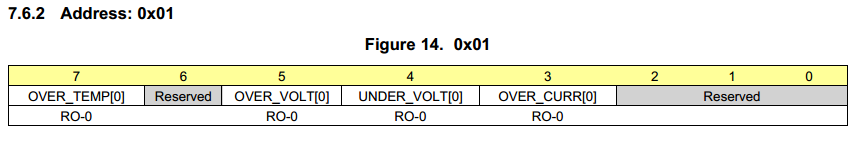

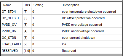

I'm using the DRV2510Q1 EVM to drive an electromagnet with a PWM on IN+ and a 3.3V level on IN- generated by an extern microcontroller. I read the register with the Haptics Control Console.
The DRV2510Q1 turn in fault with the 6th bit of the status register high.
In the datasheet this bit is reserved and this error is not explained.
What is this error and how can I fixe it?
  • Hi Nicolas,
    I am looking into this issue and should have an answer by tomorrow. It seems that the haptic control console gives the description of that register even though it should be reserved. This DC offset protection should not be enabled on the DRV2510. This is why we removed the description of that bit in the datasheet.

    This protection is also enable in the DRV2510 because the output turn off and the driver goes in Diagnostic mode.

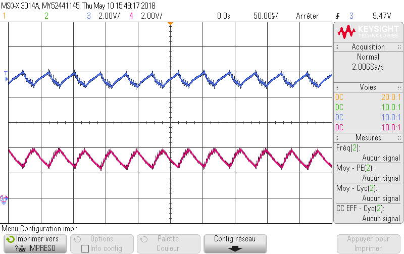

  • Hi Kelly,
    I did some test today.
    In the next screenshots blue is OUT-A and pink OUT-B.
    When I have a duty cycle lower than 50% (on IN+) the issue isn't happening but from 50% I have the DC offset protection enable.
    Here is a screenshot of my two outputs with a duty cycle of 10% and a PWM frequency of 12500Hz (screen_1). The signals are enable during the time I want. No DC offset protection occure in this case.
    If I zoom the signal (screen_2)

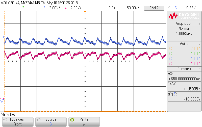

    Now I change the duty cycle to 50% (screen_3).
    We can see that the DC offset disabe the output when the signal is on during 650ms.

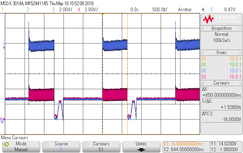

    I zoom the signal (screen_4)
    I don't understand why the DC offset protection is enable when I trie to set the duty cycle upper than 50%.
    Maybe this will help you to fixe this issue.
    Nicolas Roch
  • Hi Nicolas,
    The last two screen shots show the issue. The DC offset between the outputs is ~4.5V and then the protection kicks in at 650ms and shuts the device off.
    When the duty cycle is lower, the DC offset is <2.9V, and therefore the protection doesn't activate. The problem here is the DC protection is enabled. I will have a meeting to discuss this with my team next Tuesday and then I can update you with our solution.
