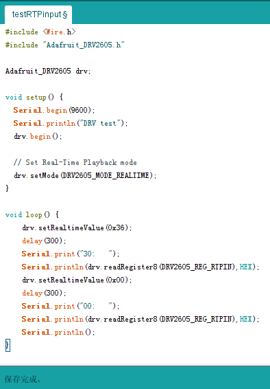

I use a DRV2605L to drive a ERM and I use the real time playback function.
but, when i input amplitude data to RTP_INPUT[7:0], the value of control register will change to 0xff or other and the ERM doesn't vibrate as the given amplitude.
