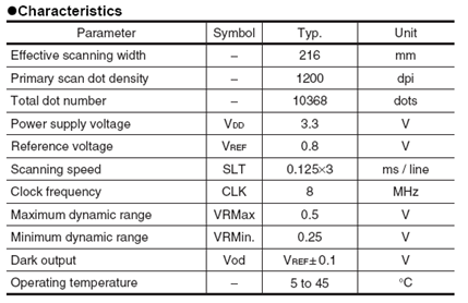

I would like to use the LM98620 6 Channel Imaging Signal Processor to interface with a 6 channel CIS from Rohm, one that is similar to the LSH1208-BD70A
However, I don't quite understand the actual analog DC input range of the component. The datasheet specifies a recommended common-mode voltage of 1.65V at each OSR input. In addition, the input range of the ADC seems to be set at 0.98V to 2.23V. The CIS I want to use outputs a voltage between 0.8V (= dark pixel) and 2V (= light pixel). If the input is biased at 1.65V during a dark pixel output voltage (as is suggested) and the CIS output is then increased to the value of a white pixel, the OSR input would become  2.85V, which is clearly above the top voltage reference of the ADC.
Therefore, the mentioned 'Maximum Input Level' of 1.2Vpp seems to be the valid bipolar voltage range, which is not suited for my application? The datasheet does mention an "Input Signal Polarity Select" option, but I don't understand what this option does or what it implies.

    Question 1: However, I don't quite understand the actual analog DC input range of the component. The datasheet specifies a recommended common-mode voltage of 1.65V at each OSR input. In addition, the input range of the ADC seems to be set at 0.98V to 2.23V. The CIS I want to use outputs a voltage between 0.8V (= dark pixel) and 2V (= light pixel). If the input is biased at 1.65V during a dark pixel output voltage (as is suggested) and the CIS output is then increased to the value of a white pixel, the OSR input would become  2.85V, which is clearly above the top voltage reference of the ADC. Therefore, the mentioned 'Maximum Input Level' of 1.2Vpp seems to be the valid bipolar voltage range, which is not suited for my application?
    [Hashemi, Hooman]  4/8/14: The LM98620 input stage has a linear range from 1.05V to 2.25V. This is derived from knowing a 1.2Vpp linear range and its center being at 1.65V. As Figure 15 shows, the input is AC coupled and then clamped internally. This is the swing value you should be using and you won’t be over-driving anything assuming you have setup your clamp properly.
    In your case the sensor appears to have a 0.5V maximum swing (dark or reference to full white), as shown below, which if added to the 1.65V clamping voltage gives 2.15V. This fits within the common mode range (1.05V to 2.25V) with no problem.
    If your sensor signal were larger, you  can provide your own clean low impedance Vclp voltage and connect that to the Vclp ext pin instead of using the Vclp int as the source. But, you don't need to do that with your sensor.
    It is possible to DC couple into the LM98620 if the sensor has a reference voltage of around 1.05V (yours does not), eliminating the need to do AC coupling and clamping, to offset the sensor voltage within the AFE common mode range.

    [Hashemi, Hooman]  4/8/14:  From your sensor’s (LSH1208-BD70A) datasheet page 3, diagram (a), it looks like your sensor output is positive going. So, in register 0x03h, you would set bit 7 to 1 for positive polarity.

    I understand your explanations, but it is still unclear to me what the "Input Signal Polarity Select" option does. If I were to use the Vclp internal as the source for the input clamping and the corresponding input range from 1.65V to 2.25V, I would only use half of the complete input range of 1.05V to 2.25V. Doesn't this mean that I lose half of the valid input range of the ADC, thus one bit of conversion accuracy? Or is the actual valid input range of the ADC affected by the "Input Signal Polarity Select" option?
    If this is the case, what happens when I use a self-chosen Vclp of (for example) 1.05V to obtain an input dynamic range of 1.2V?
    I ask this because I have done some measurements on the sensor I mentioned, and these have shown that the outputs of the sensor can easily achieve voltages of more than 2V. I am still unsure about the dynamic range I will be using in my application, so it would be nice if I have some degree of flexibility at the input of the AFE.

    1. Polarity Setting: Positive polarity means more white results in more positive sensor voltage. Neg. polarity is a lower voltage with more white pixel. Most CCD sensors are negative polarity. Many CMOS and CIS are positive (with exceptions). Polarity select gives you that flexibility so that AFE digital output will always give higher digital value for more white, if polarity bit is set properly.
    2. Input Voltage Range: The voltage range I've been quoting is for the benefit / linearity of the front end. There is additional analog offset and analog gain (having a very wide range and reach) which are incorporated inside the LM98620, as shown on page 3 Block Diagram. Even if your input swing covers only half of the front end linear range, this does not mean your digitized output is missing 1/2 the dynamic range / bit count. If you have a choice, it is always best to go with as big an input as possible, and then use less gain within the AFE for higher performance.
    For your particular large input condition, you can break the external / board connection between VCLPINT and VCLPEXT (and still use a large cap on it), as shown in Figure 15. Assuming a negative going signal, you would then use VCLPEXT voltage close to the top end of the input voltage range 2.25V as the best setting for your input.
