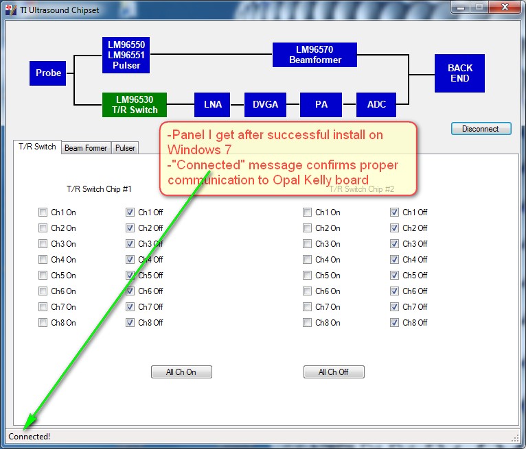

I have just  received my TX-SDK-V2 eval kit. How do I get the Windows 8.1 software to operate eval kit.?

  • Hello Hooman,
    I have downloaded all the SW from the link you gave me (thank you).
    I tried to install on Windows 8.1 machine. Not successful - USB driver problem which could be the XP virtual machine issue that you mentioned.
    So, then I tried to install on a known good Win XP machine. Not successful. USB driver install problem. The "Opal Kelly Module USB Installation" (user's guide section 2.2) Step 5 starts but never completes! The machine is really locked up - can't Cancel or Ctrl-Alt-Del. I tried this install several times on the XP machine. I killed all other processes and disabled firewall and Virus scans before install. Still no good. There are no error or warning messages.

  • Hi Dennis,
    I'm sorry that things are not working smoothly yet. Hopefully we can resolve them.
    Here are some comments:
    1. Windows 7: The TX-SDK-V2 installs / runs-well on my Windows 7 machine. I don't have a Windows 8 machine to test with. I was wrong previously when I said you must have Windows XP to install (Windows 7 also works- unfortunately, I don't have any information on Windows 8)
    2. Virtual Windows XP: If  I try the installation on the same Windows 7 machine (under Virtual XP), I get the following message:
    Do you have ".NET Framework version 3.5" installed on your Windows XP machine? You can download that from Microsoft. However, I cannot test it or install .NET Framework on my machine because my Virtual XP machine is not connected to the internet (due to corporate policy issues).

  • Hooman,
    I have fully installed the TX-SDK-V2 software on my Win8.1 machine. There are a few issues that other users should be aware of when installing the Opal USB driver:
    Important Installation steps in the order that worked for me:
    Install the front panel software - Follow instructions Section 2.1 of users manual. Do not perform section 2.2!
    Enable .Net Framework 3.5 - not sure if this was absolutely necessary but I followed your suggestion. The procedure is described here:  http://msdn.microsoft.com/en-us/library/hh506443%28v=vs.110%29.aspx
    Disable Windows Digital Signature Verification - this must be done. MS has really gone out of the way to make this PITA. I could not start the following procedure normally (as stated). I had to turn off the guest account login and start the procedure in safe mode. Safe mode is most reliably invoked by <Windows>+'R", typing 'msconfig.exe', setting boot parameters to 'Safe Mode', and then restarting the machine. I used the following procedure when in safe mode:    http://www.howtogeek.com/167723/how-to-disable-driver-signature-verification-on-64-bit-windows-8.1-so-that-you-can-install-unsigned-drivers/
    Connect the Opal Kelly USB module to the PC - see users guide Sect. 2.2 step 1. There was no response to this by my machine. Do not do any further steps from sect 2.2! (because of Win8.1).
    Install Opal Kelly USB drivers - The drivers will not be automatically found by Win8.1. So, invoke Control Panel->System->Device Manager.  Find and select Opal Kelly XEM3001v2. Then click on update driver and browse. Set the location to be C:\Program Files (x86)\Opal Kelly\FrontPanel\Driver and then hit next and finish the installation.
    Invoke TI ultrasound tools and test USB - click "Connect"  and observe good connect status.
    Restart PC - make sure that PC will restart in normal mode - not safe mode!
    MS Win8.1 driver security strategy causes this.
    TI should publish the TX-SDK-V2 installation file(s) structure and location.
    Dennis
