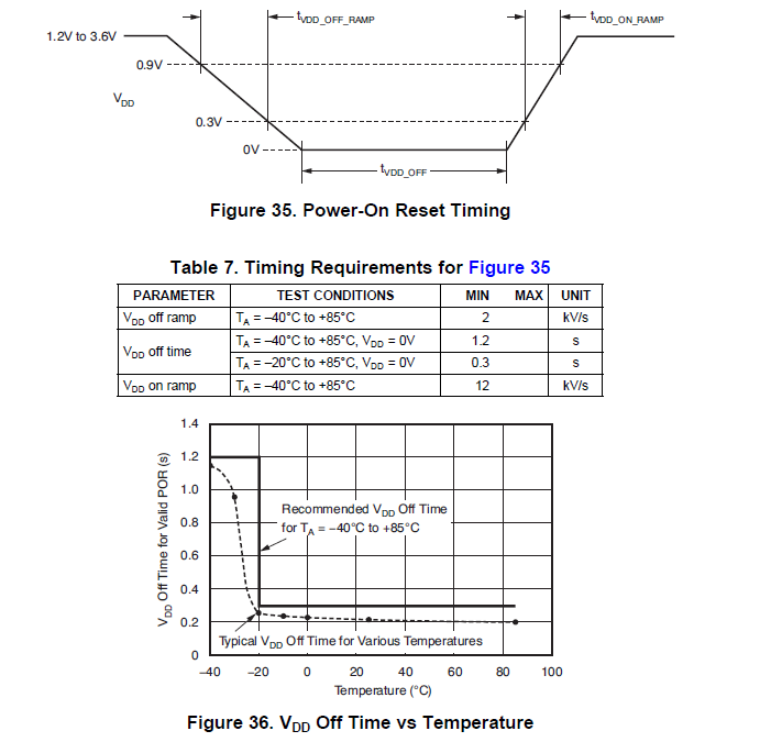

Hello.
For the TSC2046 touch screen controller, I am trying to determine the minimum time I should wait after powering down the controller, before I can power it back up again. (10 milliseconds, 100 milliseconds, etc…?).  I toggle a GPIO pin connected to "+VCC", pin 1 on the controller to do this.
I looked in the January 2008 data sheet (SBAS265G) but I could not locate this delay value. Can anyone tell me, or better yet provide the page number to a document that contains this information?

    In addition, if you put the TSC2046 into the power-down mode, the quiescent current will become very small (3uA in the datasheet). Could you tell me why you want to power on and off this device multiple times?

    I have already discussed this issue with my PE colleagues. This parameter is not listed in datasheet or any internal document, so we are trying to measure this parameter from scratch. However, due to some limitations of our current tester and test program, we are not able to take this measurement easily.
    Our suggestion is that you try multiple tsc2046 samples by yourself. From my perspective, I would say that 1.5s is a safe number.

    Finally I have got some feedback from my colleagues who were the designer of the touch controllers. The reason for the wait time between the power off and power on is that the capacitor inside the power-on reset cell does not discharge through a low impedance path when the supply turns off.  Hence, it can take quite some time in order for the power-on reset cell to operate and trigger properly during a re-start of the supply.
    I don't find the POR time for TSC2046. However, below is what you can find in the TSC2007 datasheet.  Since TSC2046 and TSC2007 are very similar devices, I think the same idea could be applied to TSC2046 as well.
    My colleague suggests you take 2 secs of the wait time between the power recycle, which should be plenty at the room temperature. Another note is that "the lower the OFF voltage is, the better! If they can get down below 0.2V or even down to 0.1V quickly and then stay at that voltage for 1.5s that should help. It is a combination out of time and VDD OFF voltage."
