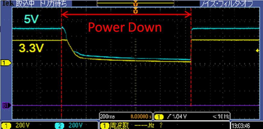

It seems tha the TSC 2004 hangs after following power sequence.
In this case, the TSC2004 would not send ack and also never output xPINTDAV.
Also the xRESET is NOT effective for recovering from this conditions.
Could you tell me know what happens and how should we escape from this condition?
