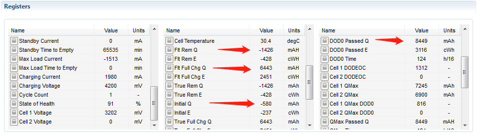

I have some boards with BQ28Z610, programmed like all the others but with strange low values of FCC against the DC value.
Analyzing the detail with bqStudio, I have noticed that, with GAUGE_ENABLED, while the load is applied, the value of remaining capacity is fixed for long time, (it is not decreasing like I am expecting) but the value of passed Q is increasing.
the Update Status is 0e, the QMax is higher than the Design Capacity ....
What the hell is happening?
Please help me, it is urgent.....

    I add also a copy of a screenshot: the value of FFC is clear from 8449-1426-580=6443 but it is correct? I was expecting the true remain q will be scaled to 0 when the charge termination is reached, FD bit set, but like I have told, I do not know the algorithm of the sw. the important is I can pass this strange behavior....

  • Hi Maurizio,
    It would help us to see all of the registers from the fuel gauge and witness the problem in action.
    Can you please capture a logs using bqStudio on a good battery and a "bad" battery?  Please capture at least 15 minutes of data, but if you can leave it longer then it's even better.  If you can log overnight it would be best.  Then extract .gg.csv files from each battery you captured a log from and zip the logs and .gg.csv files and attach to a post here for us to analyze.

  • Hi Maurizio,
    Without a direct log of your cycle I can only guess what could have possibly occurred. It is possible that with smoothing enabled, (you can disable this in Configuration: IT Gauging Configuration by setting the SMOOTH bit to 0) your calculations were possibly affected by a cycle wherein the last dsg cycles didn't have rest in between them to allow for a DOD reading to catch up. Otherwise your DOD update would have sync'd your FCC to it's correct value when passed chg cleared.
    My suggestion is if you have followed all the correct procedures (flashing chem, updating gas gauging parameters) before doing the LC, please allow your battery to rest for 5 hours. You will see this issue go away.
