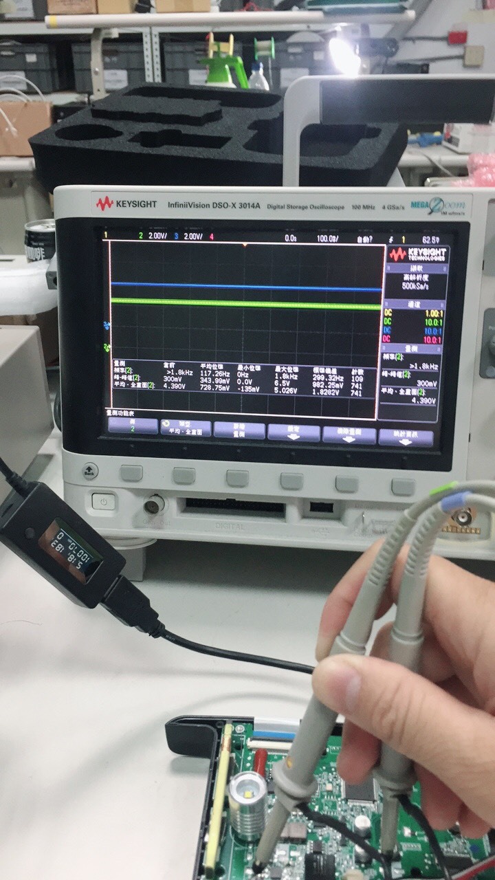

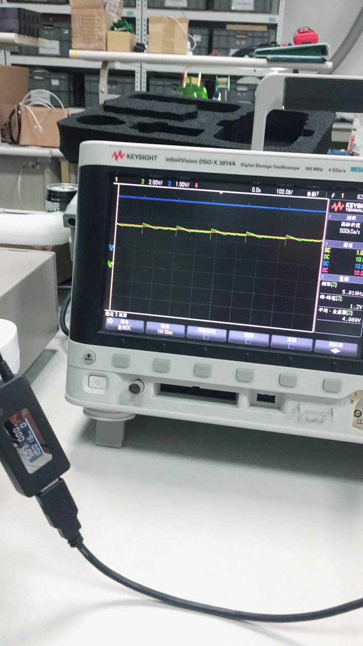

Hi Hong,
I measure Failure BQ25606 waveform with VBUS/ BAT pin then find abnormal status as below.
Fig 1 & Fig 2 is different PCBA.
Please kindly provide your suggestion for our reference.
Thanks.
Fig 1. Blue is BAT voltage (3.07V), Yellow is VBUS waveform then Chagre Current is Failure (0mA).
Fig 2. Blue is BAT voltage (3.07V), Yellow is VBUS waveform then Chagre Current is OK (1.38A).
Eric
