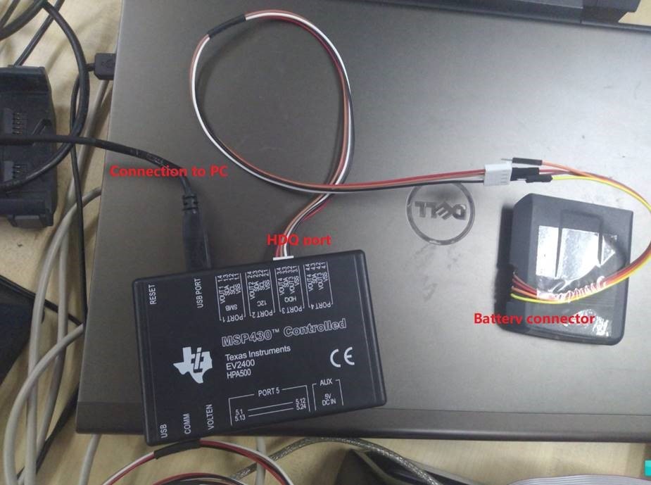

Now have EV2400 in hand, and downloaded bqstudio, but can't connect PC-EV2400-Battery successful, could you please suggest this part also?

    I can't get bqstudio to work, is there any tip for that? and is there any guide line on get ev2400 and bqstudio to work?
    Could you please check the pictures i attached in original post? if there is abnormal?

    Yes, I have one EV2400, refer to the picture. is this enough for debugging?
    Liberty
  • Hi Liberty
    No, I am talking about an EVM for the bq27545-G1. This will allows  for apple to apple comparison to understand what is going on with the gauge.

    We do not have a schematic of your design to know why you are unable to communicate with bqstudio. I suspect you may not have a pull-up resistor on the hdq line to 3.3v. You will have to open up your pack and debug why you do not have communication.
    The EVM is to help your debug process so you are able to compare a functional board to your non functiona boards. your call

    for Communicate with bqstudio, I want to confirm my connection are correct, Currently I connect VSS and SDA from HDQ port on EV2400, is this enough? I also tried to connect VSS of HDQ port to battery's Positive pin, is this correct to pull up EV2400, or I need apply extern 3.3V to HDQ of EV2400?

    your ground should be connected to vss and your hdq pin to the hdq of the ev2400 and you should have a pull-up to the hdq
