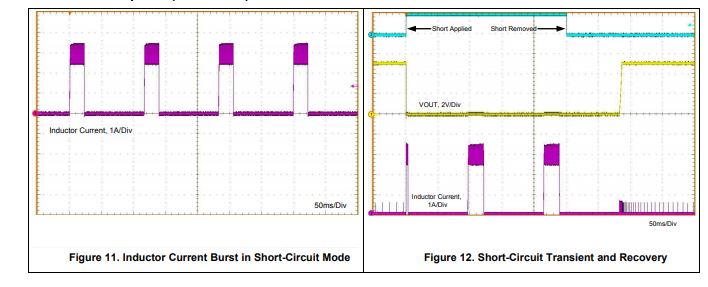

It is described as 500A - 600A in the Short - Circuit Output Current graph of Fig. 3 of the data sheet.
Can the current flow from 500A to 600A when this device is short-circuited?
Best regard.

    From the graphs of Fig11 and Fig12, the inductor current is 3A,
    In Fig 3, it ranges from 500A to 600A.
    The range is different, which of Fig3 and Fig11, Fig12 is correct?
    Best regard.
    Bob Lee.
  • Hi Bob,
    All three figures are correct. Figure 3 shows the average DC output current, while Figure 11 and Figure 12 show the inductor current. The hiccup performance seen in Figure 11 and Figure 12 lowers the average output current (Figure 3), and consequently improves the thermal dissipation during short circuit.
    Please let me know if you have any additional questions.
    Katelyn

  • Hello Bob,
    Q1:
    The output current will vary depending on the inductor current.  The output current is the average of the inductor current.  The below image shows the inductor current will vary from 0A (0A output current) and 3A (hiccup event).  If you measure the output current with a DMM over a large enough time range, you will measure the average output current of both the 'off time' (0A inductor current) and the 'hiccup time' (3A inductor current).
    Q2:
    You can measure the output current during short circuit, by shorting the output and measuring the current with a DMM.
    Please let me know if anything remains unclear or if you have any additional questions.
    Katelyn Wiggenhorn

    Q3
    What is the inductor current when the output current in Fig.3 is 500A to 600A?
    Is there a circuit diagram at that time?
    Q4
    If the inductor current is 0 A and 3A as shown in Figure 12,do you think that the output current of the average current of the inductor will be 500A to 600A as shown in Fig. 3?
    Best regard.
    Bob Lee.
  • Dear Katelyn,
    I thought about average of the output current.
    The LMR33620 is equipped with Hiccup mode.
    This current value is limited by overcurrent Operation of 3.5 A (typ).
    Hiccup mode operation Duty is (on 20 msec typ, off 94 msec typ) .
    When it calculate the average value current from this operation,
    The average of the output current is Isc = 3.5 A / (20 ms + 94 ms) = 0.614 A
    Is the might be unit in Fig 3 not A but mA?
    Best regard.
    Bob Lee.
  • Hi Bob,
    Yes, this should be in mA. Thank you for pointing out this discrepancy. I believe this is the reason for the confusion between us.
    I apologize for this mistake, and I will share this with the author.
    Please let me know if anything is still unclear, or if you have additional questions.
    Katelyn
