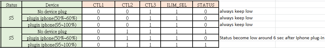

    Now customer consider to implement this feature differently, and decide to choose the Power Wake feature described in datasheet (8.3.6.1 Implementing Power Wake in Notebook System).  We have some questions at this moment,
    In datasheet "8.3.6.1 Implementing Power Wake in Notebook System", the Power Wake feature is implemented with .       CTL1/CTL2/CTL3/ILIM_SEL configured as "0011"--> Power Wake Limits.  Customer try to implement this during S5 mode, but found the STATUS behavior is not as expected.  It's always low even when no device connected.  In parallel, customer implement it with these 4 pins as "0111" --> Non Power Wake Limits, the behavior looks normally.  Here're some related questions.
    1. Regarding the test result, is it because "Power Wake Limits" is much smaller, and there could be some small current even when nothing is connected??  So, STATUS keeps low at this moment?
    2. Can customer implement "8.3.6.1 Implementing Power Wake in Notebook System" with these 4 pins configured as "0111" instead of "0011"
    Thanks!
    Antony
  • Antony,
    The table you have shows that the Power Load Management function in Figure 33 is in place for the first 3 modes and is functioning as expected.
    1. in the first half (0011), if more than 45mA drawn, then status will be low and the port will be in charge mode. It does not make use of the USB data lines in this state, so it is possible to have the bus powered on a disconnected port.
    2. In the second half (0111), Load detection based on USB datalines so their state will determine the discharge/charge connections, so it will transition to high in 2 conditions to tell they system that it is ok to switch to a lower current regulator because the draw is below 45mA.
    If the customer has a MCU to interpret the results and switch the appropriate regulator, then they are able to use 0111 for their system.
    Chuck
  • Hi Chuck,
    For either case of "0011" or "0111", both are DCP_AUTO with data lines disconnected.  Why did you mentioned the load detection is based on USB datalines for "0111"?
    For case of "0111", the load detection is based on "non Power Wake limits" which is around 700mA.  Does it mean STATUS will be driven high when the currnt drawn is less than 700mA?
    THansk!
    Antony
  • Antony,
    If you look at figure 8.3.6.1, it shows using the 0011 case for Power Wake with a controller.
    You table makes sense for this case.
    The LDO should be selected to keep VBUS present on a cable that is disconnected (less than 45mA) (No Pllug)
    The DC-DC converter is selected when the current requirements are above 45mA (50%-60% charged Iphone)
    The LDO should be selected to keep VBUS present on a cable that has a light load (95%+ charged Iphone)
    The Status line is low only when the DC-DC is required in 0011 mode.
    When you select 0111 mode, the TPS2546 expects some other element in the system to manage the power mode, so status is always held low to turn the DC-DC on.
    From what you have described, your customer should use 0011 mode for their system and then manage how to switch between the LDO and DC-DC with a simple MCU or other mechanism to handle the power source switchover.
