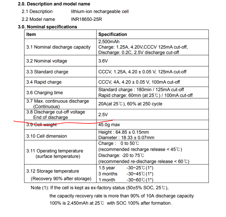

May I know what is OCV @DOD 100% in CHEM_ID curve for li-ion or LPF4? I want to set EDV to 2.6V and worry about 2.6V would be out of DOD range in IT gauge, especially in light load condition.

HI Mark,
The EDV0 (terminate voltage) for the cell is defined by the cell manufacturer and will be found in their datasheet.
