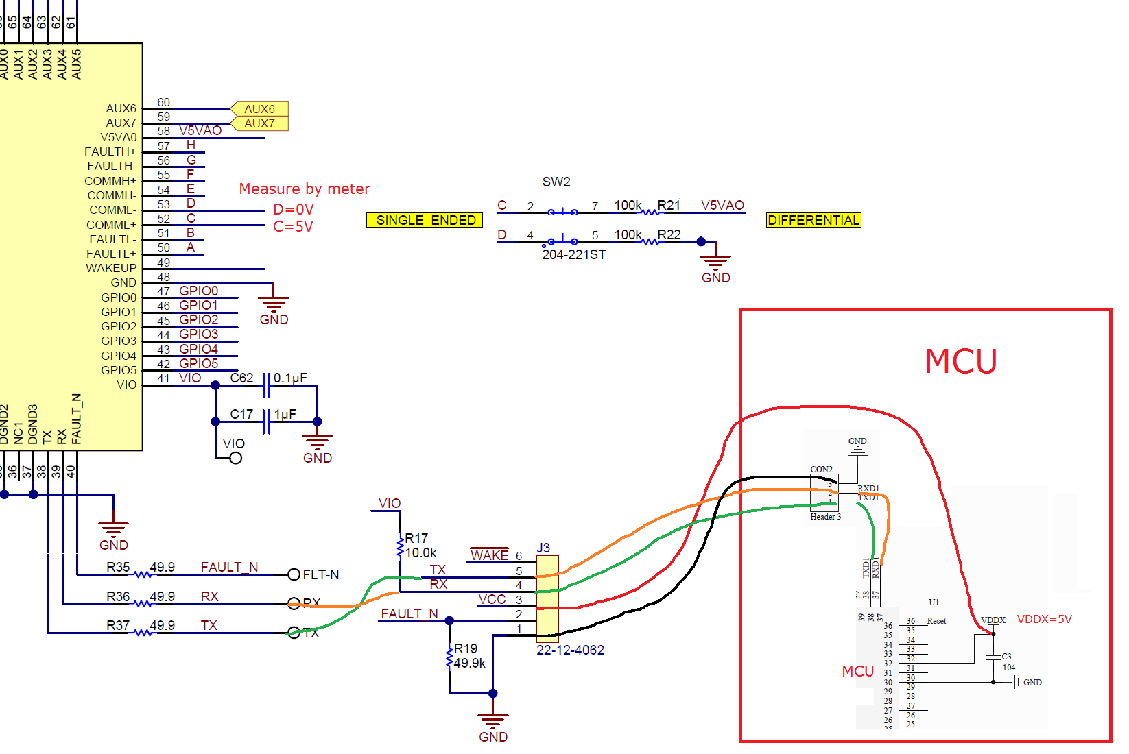

Our MCU provide +5V for BQ76PL455A. The RX and TX signal as following.
Yellow: BQ76PL455A RX
Blue: BQ76PL455A TX
The high level of TX is about +4V and low level is 0.4~0.6V. Is it normal?

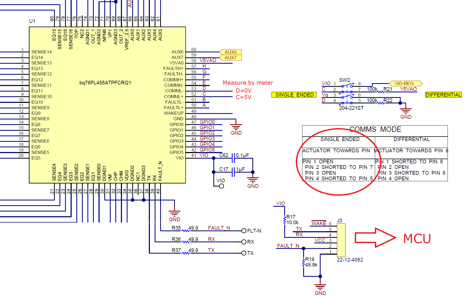

Hi Jet,
Are you connecting uC directly to PL455A evm?
Can you show me how you connect VDDX and VIO of PL455A EVM?
