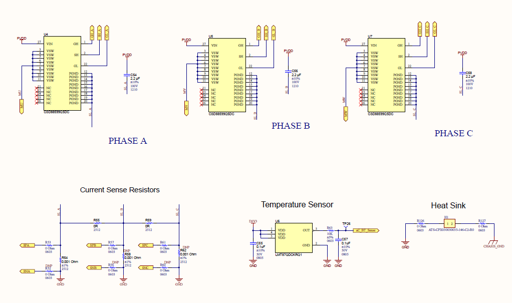

    I am not able to share the complete schematic but i am sharing part of it (Protection Circuit, DRV8323 section & H-Bridge Section). Hope it will give you fair idea. The operating voltage is 24V from Lead Acid Battery.

    The schematics gave good understanding on how you are using the device. Thanks for the details.
    Can you share a test waveform of Vin, Vout, Input current and GATE voltage for LM5060 device to analyze the stress on MOSFET Q1 during startup. I see, 380uF x 2 caps at the output, which causes inrush current and stress on MOSFET Q1.

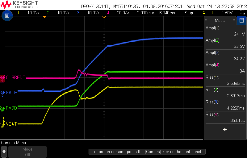

  • Dear Rakesh,
    Below are test waveforms of Vin (VBAT- YELLOW), Vout (PVDD-GREEN), Input Current (Current- PINK) & GATE Voltage ((GATE-BLUE). While capturing waveform i used CC-CV power supply. Power supply voltage is set to 24V and current is set once to 5A & once to 25A. We observed failure failure when we worked with power supply current limited to 5A. I captured waveform with 25A current limit to simulate as if connected to battery (no current limit, current only limited by LM5060).
    Waveform with power supply set to 24V & 25A current:
    Waveform with power supply set to 24V & 5A current:

  • Hi Amit,
    Thank you!
    Can you repeat second test (power supply set to 24V & 5A current) without 380uF x 2 caps at the output.
    These waveforms are at no-load. Is it close to the actual scenario? I mean, you will enable the BLDC motor only when the LM5060 powers up the output?

  • Hi Rakesh,
    I have not repeated 2nd test (24V & 5A) without 380uFx2. As of now, failure of Q & Q3 (IRFB7440PBF) but now we are having failure issues with U4,U5 & U7 (CSD88599Q5DC). So we are breaking head on this now. It will be really helpful if you support.
    All waveforms captured at no-load. In actual scenario, we will enable BLDC motor only after LM5060 powers up the output.
