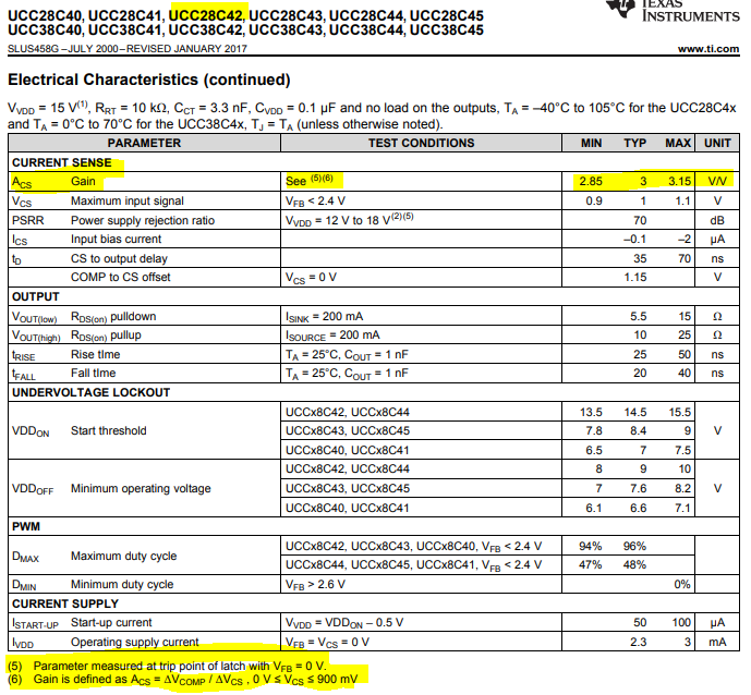

  • Hi Teng,
    Thanks for detailed explanation. Please have a look at attached.
    I am talking about ACS parameter.
    Swamy M.
  • Hi Swamy M.
    Thank you for position.
    I found that maybe you had some misunderstanding of test condition.
    From the datasheet we can see the test condition is:
    The voltage range of Vcs is 0~0.9V, rather than varies from 0 to 0.9V.
    Then Vfb makes a transient jump from current value to 0V, and calculate Acs = △Vcomp/△Vcs during the transient process.
    So we can not say COMP Pin depends on CS input, it should be explained that the voltage variation of Vcomp leads to the voltage variation of Vcs during the transient process.
    Teng
  • Hello Tang,
    Thanks for your clarification.
    I tried the same in TINA in simulation. But I didn't see any voltage change on CS pin.
    I changed FB voltage from 2.7 to 0V, so that COMP will change 0 to 6.5V. Correct me if anything wrong here.
    Swamy M.
  • Hi Swamy M.
    First, change voltage of FB Pin from 2.7 to 0V, voltage of COMP pin is changed from 0 to 6.5V, it is accordant with that I explained before.
    The reason why you couldn't see any voltage change on CS pin is that the CS pin is an input pin, which is used to sense Primary-side current by connecting to current sensing resistor. But your simulation module is just a open-loop test, there is no signal connecting to CS pin.
    Teng
