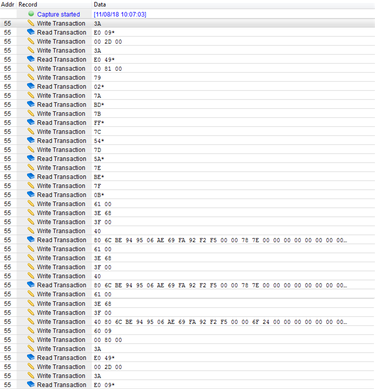

I'm looking to calibrate the bq34z100-g1 (voltage, current, temperature) using a python script for production use.
I've used Battery Management Studio to calibrate the voltage, and viewed the generated i2c commands, but I'm not making sense of it.
Can you explain the process or Is there documentation for this?

  • Thanks Bryan,
    I already have a routine to parse and program the golden file (.bqfs, or .dffs) over I2C.
    After this, It seems to me that each device will need to be calibrated individually to be accurate.
    For this reason, I was asked to also create a script to assist with calibration of the voltage readings etc.
    Below is the I2C data for an example to calibrate the voltage reading, where for this case, the voltage guage reading is displaying 23124mV, and I then set the applied voltage to 21330mV in Battery Management Studio:
    I need to understand this so I can duplicate this for a general case where a user will enter a new (actual) voltage that might differ from the displayed voltage.
    The routine seems to be reading the Calibration class and changing the  voltage divider data at offset 14/15, which sort of makes sense, but there are other things going on here that I don't understand.

  • The I2C calibration routine I posted above, from the Battery Management Studio seems to do the following:
    1. Enable Cal mode
    2. Enter Cal mode
    3. Read Reserved command 0x79 through 0x7F.
    (Two of these bytes seem to indicate the voltage reading, but I can't be sure since they are not documented.)
    4. Generate the new voltage divider calibration value.
    I believe they use data from the reserved register, along with the "Applied Voltage" value to generate a new voltage divider calibration factor.
    I can't figure out how for example, they generate a voltage divider calibration value of 28424 when reading a voltage of 21294mV with the Applied Voltage of 21300mV.
    Any help would be appreciated.

  • Hi Andy,
    I apologize for the delay - have been able to break the logjam on this issue:
    Voltage offset is not a separate value when performing calibration with the bq34z100-g1 and bqStudio. The voltage divider parameter is used to calibrate, more as a gain.
    Then, make sure to toggle cal_enable and enter_cal
    Then, we will need to determine the rawVoltage. To do so, use commands:
    0x7C - rawVoltageLSB
    0x7D - rawVoltageMSB
    rawVoltage = (rawVoltageMSB << 8) + rawVoltageMSB
    Next, measure the actualVoltage of the battery with a multimeter.
    Then, calculate calibratedVoltageDivider:
    calibratedVoltageDivider = actualVoltage * voltageDivider / rawVoltage
    Round calibratedVoltageDivider to an unsigned 16 bit value and write the value to Voltage Divider in dataflash.
    Finally, exit_cal and toggle cal_enable
