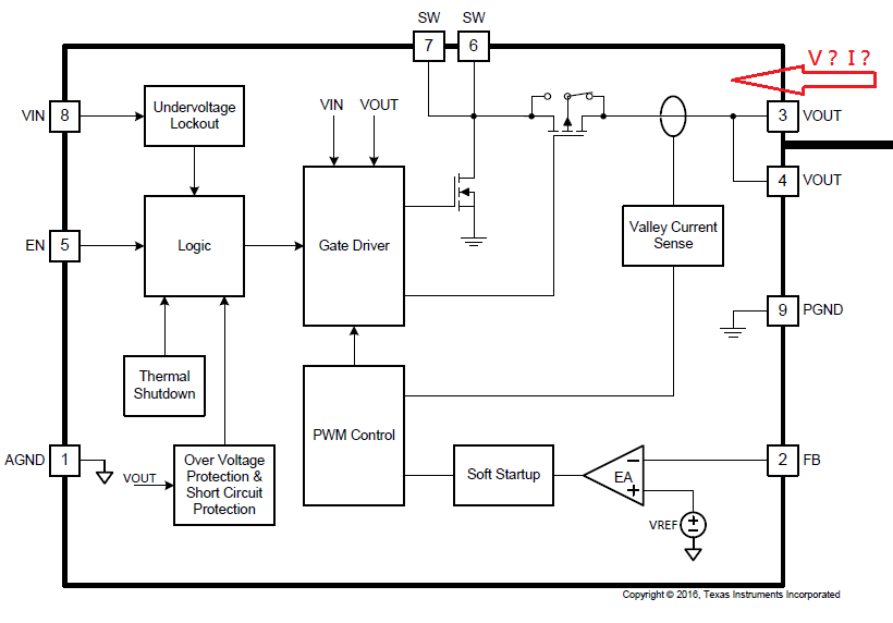

Dear TI Sir
Below is TPS61021A/TLV61021 block diagram.
I would like to know V? I? of TPS61021A/TLV61021
Dear Sir,
Do you mean the output current, output voltage? I can't understand what your mean?
Dear Sir,
If you mean it is the voltage and the current from the load, then the maximum external added voltage can be as high as 4.6V, but suggest leave some margin, so 4.2V should be OK. For the reverse current from the load side, actually, once there's reverse current, the high side FET will shut down.
