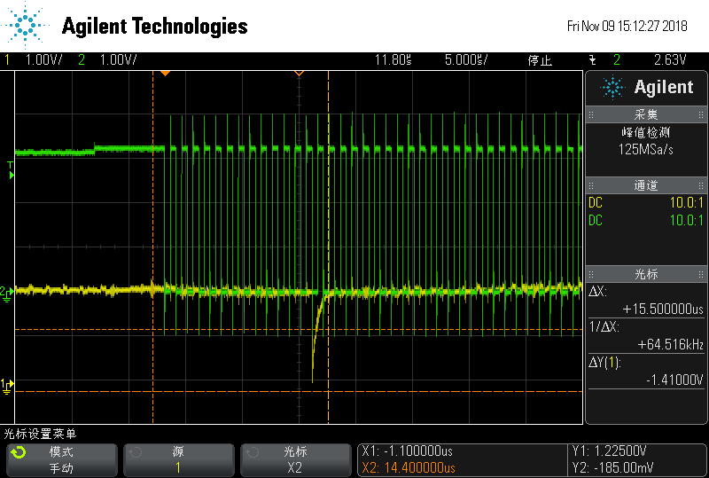

  • Hello Jimmy
    Sorry, I got wrong your picture. Please see the following picture. The blue is CLK, and yellow is PG. As you see, there will have a little drop after CLK mode used about 10us.
    The input voltage is 5.2V and output is 1.1V. The CLK frequecy is 800khz. So could you look more about it?
  • Hi Xiao,
    If possible can you also attach your schematic. I want to have a full picture of your system. What RT resistor were you using? Ideally I want to test the EVM with your system application to get an apples to apples comparison.
    Just to clarify, it sounds like you are observing the PWRGD going low after transition from RT mode (set by RT resistor) to CLK mode (external clock generated). As I've shown you above in the scopeshot, I didn't see any unexpected PWRGD drop.
    Jimmy
