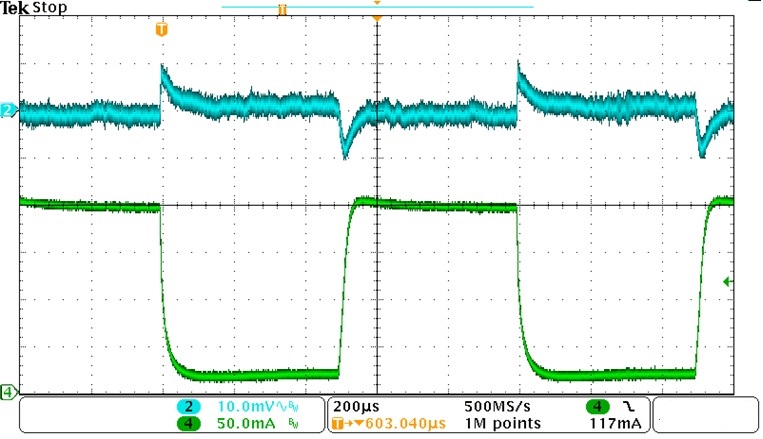

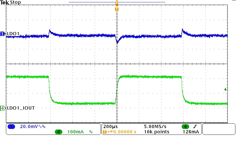

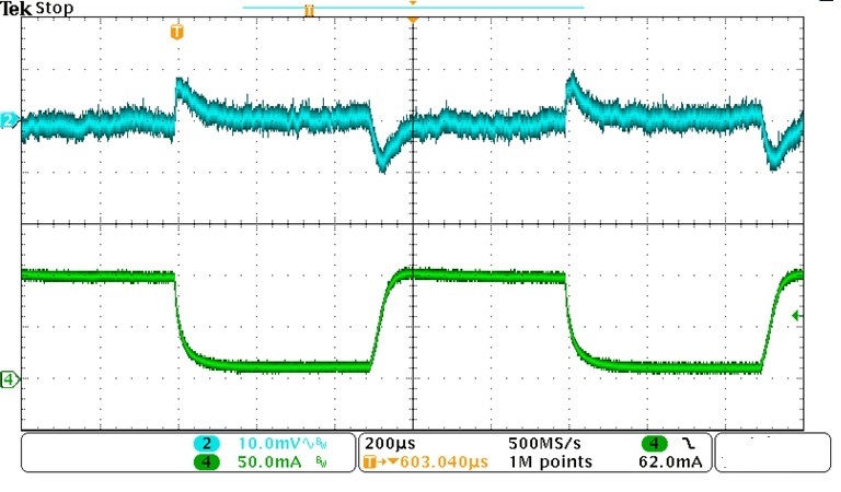

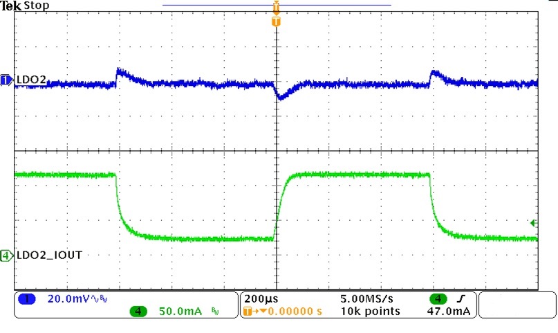

Can you provide the load transient response of two LDO in TPS65262-2 ?
