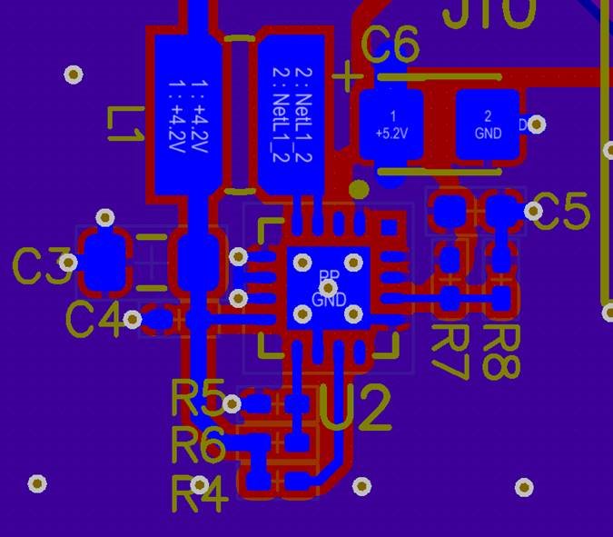

So I'm using your TPS61030 chip in my circuit as shown below, but the circuit was not producing enough amps to run my system. Below is figure of my circuit with your TPS61030 IC chip.
I then found out your web sight has a circuit simulator for this particular chip, that depending on your input values it makes a circuit for you, which is nice. Here is the your websites simulator for reference: https://webench.ti.com/webench5/power/launch_wb.cgi?part=TPS61030&fromdisty=digikey
Then here are my input values for that web sight
Then this is the circuit it pumped out
So it looked like to me that all I needed to do was replace a few values of the chips around the TPS61030 IC chip. So I switched out the R4 340K ohm resistor, in my circuit, to a 200K ohm resistor, I also switched in a 330 uF capacitor for C6, and a 3.3uH inductor for L1.
I then tested this to find out that your TPS61030 IC chip would only produce the amps I needed if given 3.7 V or over. But I needs it to produce up to 1.3 Amps of current with an input voltage as low as 3 V, like I inputed into your online circuit simulator. What is going wrong and how can I fix this? I'm hoping that I can just replace the values of certain chips rather than redoing the schematic on my new PCB. Once this problem is solved I will be able to finish my senior design project at USU and begin manufacture of my product; therefore, buying in bulk from you guys on various parts. Thank you for the support! Please give me a call or email me if you have any questions.

  • Hi Kai,
    Could you share your layout? i can check if the issue is not caused by the layout.
    you mentioned the device can't support 1.3A when VIN is lower than 3.7V. so what happen if the VIN=3.6v and IOUT=1.3a. Could you measure the waveform of the input, SW and output?
    i would suggest 6.8uH inductor to reduce the current ripple.

  • Hi Kai,
    the first picture is the schematic, not the PCB layout. I didn't see problem in the schematic, so i want to check the PCB layout. this application note is about how to make a good layout "www.ti.com/.../slva773.pdf"
    The device should support this current from 3V input. so I don't know what is happen in your circuit. that is why I need the VIN, SW, VOUT waveform to debug the circuit. here is a blog about debugging a boost "e2e.ti.com/.../tips-in-debugging-a-boost-converter". I can only make right suggestion after finding the root cause.

    The layout was created by an expert that has over 50 years experience. I'm a student and my job is designing the schematic, he creates the PCB files from my schematic and designs the layout so I'm sure the layout is correct. I don't have the layout files with me but I can ask him for them, if you really think that is the concern.

  • So I went into the lab today and looked at the TPS61030 chip under a microscope and it looked like some of the connections may have not been completely soldered correctly. Is it possible that, that may be the problem? That the power booster could still work with only some of the connections soldered, but consequentially not produce over 1 Amp?
  • Hi Kai,
    the switching waveform is not correct. you can find what does the SW waveform look like in my blog "e2e.ti.com/.../tips-in-debugging-a-boost-converter"
    could you try to check the behavior in two other boards?

  • Hi Kail,
    The device can support 5.2V 1.3A from 3V input.
    the output current does change with input voltage, as the device limits its input peak current. please refer to this application note for the calculation. "www.ti.com/.../slva372c.pdf".
    I don't understand how do you get 39% or 42% in the calculation.
    I would suggest you apply or buy an EVM form TI.COM for reference.
    I don't find issue in the boost converter schematic. one problem is the Q1 for LED circuit. it looks strange. I'm not sure if it is correct.
    before manufacture of your project, it normally requires validation of the solution in several boards. so I don't understand why do you only have one board.
    you mentioned the connection of the IC is not completely correctly. please try to re-solder the IC.
    please also share the image of the layout.

    Also below is a view of the circuit layout you asked for. This is looking at it from the bottom side of the PCB. Is this the layout picture you are looking for?
    Thanks again for helping me out!

    changing R4 to 200K don't help the issue. for the C6, if the spec of the capacitor is closed to the one used in the EVM, you don't need to change it to 220uF.
    yes, the image is what I was looking for. I think the pin 5~7 should be connected to the thermal pad directly. but it may be not the root cause of the behavior you observed.

  • Before you mentioned the below about the PCB layout:
    So you're saying pins five though seven should be connected to the thermal pad? The below shows pins five through seven on the IC chip data sheet.
    When the data sheet does not show those pins connected the the thermal pad directly as shown below. I'm confused could you please clarify.
    Also concerning the original topic before why did you change your mind about the C6 capacitor? Originally you said my schematic looked good with the single 100 uF capacitor, but now you changed your mind saying I need two 100 uF capacitors in parallel or a single 220uF capacitor. Why did you not mention this in the beginning?
    Is there a way I could call and talk over the phone with you or another engineer that specializes in this IC chip?
    Kai
  • Hi Kai,
    I am not sure if you are aware that the TPS61030 has two package, PWP and RSA. the first image you share is PWP and the layout image is RSA package. the pins definition of the two packages are different.
    The capacitance of the C6, 100uF or 220uF, should be not the root cause of the behavior you observe from my experience. so I didn't mention output capacitor at the beginning. I had been working for switching power for more than 20 years.
    as the datasheet suggests 220uF capacitor, I suggest 220uF to avoid any confuse. I apologize for no making it clear from the beginning.
