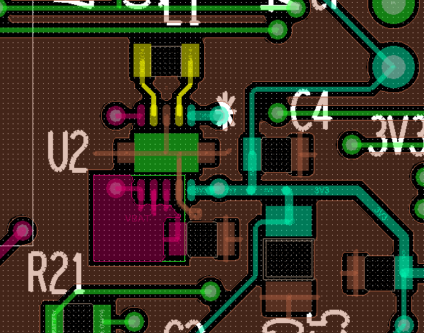

    The board layout for the regulator is shown below.  Colors indicate:  Brown = Ground, Yellow - L1/L2 inductor connections, purple is Vbat, aqua is 3V3.  The green region under the TPS63001 is the thermal pad that is also connected to ground.

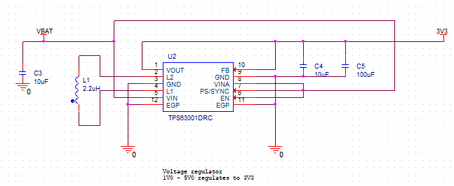

    The accompanying schematic:

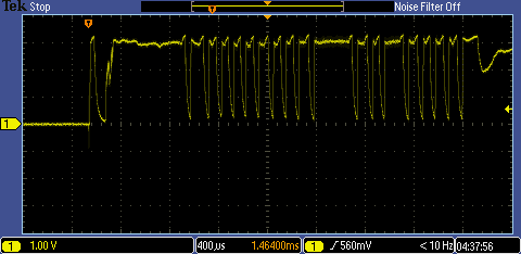

    You mentioned that the input current might be greater than expected.  I captured these using a scope and an ADS8210 current shunt with a 1.1 ohm resistor.  Current is scope voltage / 22.
    The first trace is at 40us per div, and I read it to be about 3.1V peak (/22 = 140mA).
    This capture is 400us per division/  The first peak is still present, but then it looks like the oscillator is starting up?  The peaks are all right around the same (3.1V = 140mA)
    Finally, this is after the the system has reached steady state.  The voltage is flat and level at about 2.1V ( / 22 = 95mA).  There is a CC1310 module on this supply, but its in deep sleep when this is taken.

    Thank you for this information. The input current of your power supply is too high when there is no load on the output.
    I expect that the biggest contributor is the inductor. Please replace it with one that has a lot lower series resistance. 429 mOhm is extremely high for a power supply. Please check with an inductor that has a series resistance of less than 0.1 ohm.
    And we recommend to use an RC filter connected to the VINA pin to reduce noise coupled into the VINA pin.
    In addition, your layout is not optimized for a power supply. Please have a look at the layout recommendations we have in the datasheet. I expect that your layout causes a lot of noise in the system.
    As it is almost impossible to make an existing layout better without ordering a new board, maybe it would be a possibility to take the TPS63000 EVM and check if your system can be supplied through the EVM. If this works out, exchange the external components on the EVM with your components and check if the issue comes back.
