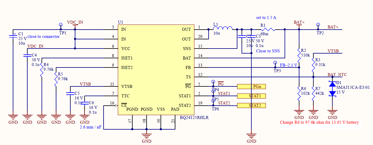

I designed the charging circuit with BG24125 to charge a 3s1p Lithium-Ion battery. See the schematic below.
However, when I attached a battery (10.8 V), it's not charging.
The voltage at ISET1 --> 0, indicates it's not charging. The voltage at ISET2 --> 0.1 V. The voltage at TS --> 1.5 V. And STAT1 is on (pull to gnd), STAT2 is off (pull to high).
I couldn't figure out what's going on. Any suggestion would be appreciated.
