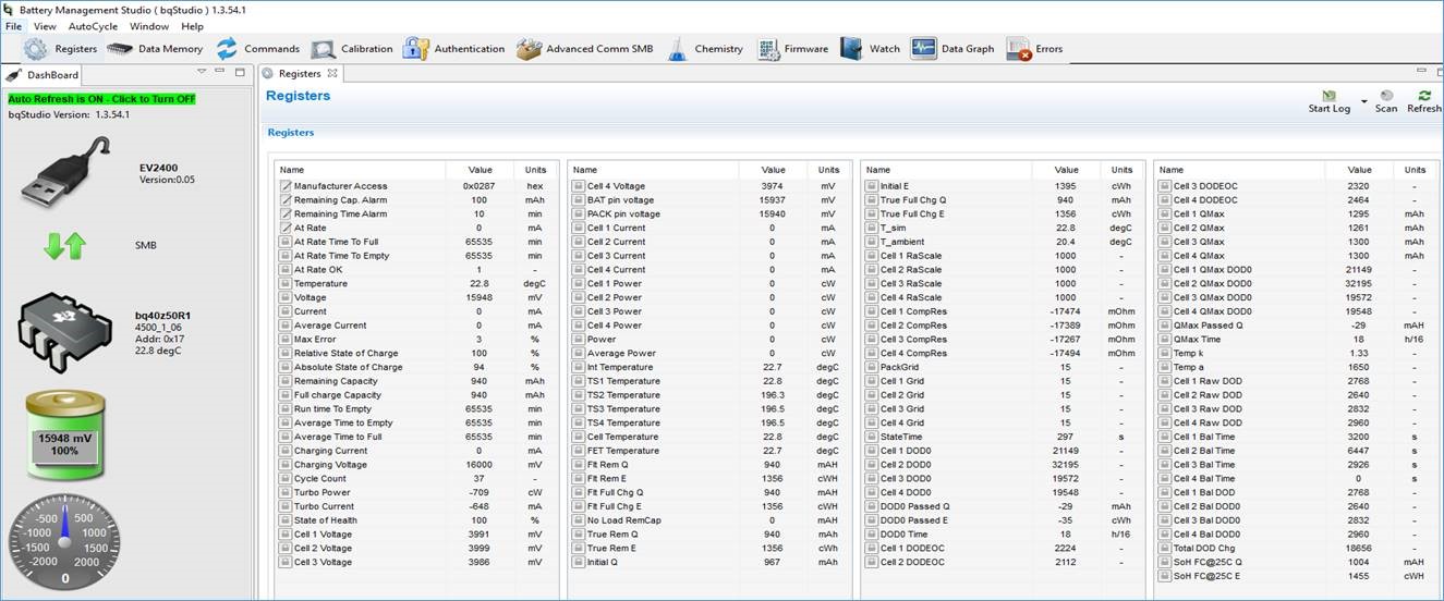

BQ40Z50-R1: RSoC Stuck at 0 after charge but then jumps to 100
Part Number: BQ40Z50-R1
We have one battery pack that is showing RSoC being 0 after charging and sitting for 24 hours.  When checking the BattStat, we get 0x03C0.  This seems to indicate the charging chip gauge is still in initialization.  If we briefly connect to a power supply, the BattStat changes to 0x0080.  That seems to indicate the gauge initialization is complete.  We noticed that battery current is -8 but jumps to 580 when the the BattStat changes to 0x0080.  As soon as BattStat changes to 0x0080, the RSoC jumps to 100 (we expect it to be at 100 the entire time).  We believe it charged so it's unclear why we are seeing RSoC at 0.  We have 3 other packs and they are not having this issue.  Is there an error happening?  Am I missing something?
