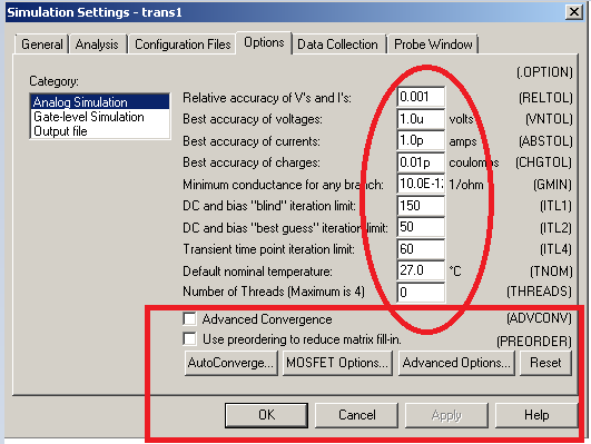

  • Hi Gerardo,
    There is no issue with schematic and I am able to run simulation with simulation settings as per published model (at website).
    Below are the images for you reference. Please update your simulation settings and let me know if you still face convergence issue.
    Also, note that SKIPBP is ticked in simulation settings to Skip initial bias point calculation.

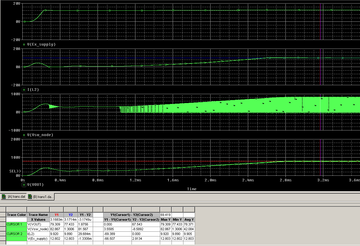

    Simulation Results:
    Steady State
  • Hi SAKET,
    Thank you.
    It works. I mean, I ve just solved the convergence problem but now, I have another problem on the Output (should be 325V). So, I am gonna check and I hope to figure out what is wrong.
