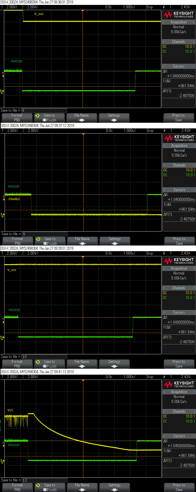

  • When EN is low, we are measuring 0V on VCC.
    This seams to be normal operation,
    "It will turn on when the VIN voltage exceeds the typical 4.1-V UVLO threshold and the EN voltage exceeds the typical 1.21-V enable voltage threshold. ... When both thresholds are exceeded, the VCC LDO output comes into regulation."  - 8.4.1
    Does this mean that PGOOD will not be reliable when EN is low?
  • correction, VCC is not 0V. When EN is disabled, VCC slowly decreases from 7.5V to 1.8V.
  • Hi User,
    The PGOOD control circuit does need some voltage on the VIN pin to function.  When EN is low to disable the IC, the PGOOD will be pulled low if VIN<5V in all worst case conditions (including hot).  At room temperature, of lower, the needed min VIN is about 3.5V to have PGOOD in function.  So, in your case of VIN not lower than 12V, the PGOOD will be low if EN is low.
    Hope this clarifies.
    Youhao
  • I made some plots to better show what is happening.
    I only have a 2 channel oscilloscope, so i was not able to capture all signals in one go, but i tied to be consistent on all the plots.
    What I am doing is that i am running the booster normally, and then turning setting the enable pin low. After approximately 7 seconds the PGOOD signal turns on again, without me changing the enable signal.
