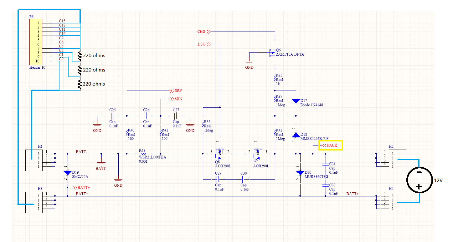

Good day, I built a BMS board in which I use the BQ76940 and a PIC24 as microcontroller. Here is the schematic (I used Altium): /cfs-file/__key/communityserver-discussions-components-files/196/0383.Schematic.rar
Is it possible to power up the board using a 12Vdc battery (instead of 36V, as I currently don't have a dc supply)? I just wanted to check if the BQ76940 REGOUT produces 3.3V which should power up my microcontroller. However, I do not get any voltage from REGOUT. Checking REGSRC also, I do not get any voltage. And so I thought maybe I need 36V for it to work.

  • Hi, thanks for the response!
    Can you please check my setup if there's anything wrong with it? I used http://www.ti.com/lit/df/tidr773/tidr773.pdf as reference.
    And 2 questions;
    (1) I just realized there is nothing connected to the PACK-(yellow box) anywhere in my schematic, as it was only used in bq78350, which I replaced with another MCU, PIC24. Should it be connected to another net?
    (2) Can you please tell me how the PACK- gets pulled down to GND (BATT-)?
  • Hi Robert,
    Thanks for the picture, this helps with understanding.
    The BQ76940 operates with power from the battery cells (BATT and C0 to C15).  When it is on and conditions are normal it can enable the output of the battery assembly, often known as PACK, however it is named H2 and H4 in your diagram.  To operate your board for initial test and software operation, connect the 12V from H1 to H3 rather than H2 to H4.  The 12V will then divide to provide 3 simulated cell voltages for the lower cell group of the BQ76940 and provide a current path to the H2 and H4 terminals.
    1. PACK- should not need to go anywhere else if you are not measuring the PACK voltage.
    2. In this test setup, only the bottom group of cells will have power, so the BQ76940 will have a XREADY fault which can not be cleared.  This will prevent the MCU from setting the DSG bit, so Q8 will be off.  CHG has a load detect feature which pulls down on the CHG pin, see the data sheet.  The pull down will come through the Q6 body diode, R35, R37, and D18 to PACK-.  If you put a meter across the pack terminals you will measure a voltage, perhaps about 80% of the BATT voltage.
    Once you have a setup with all cells connected or simulated, XREADY can be cleared.  If the voltage is sufficient to avoid UV you can set the DSG_ON bit, it will output DSG high which will turn on Q8, PACK- will be pulled down through the body diode of Q9 if or until CHG is enabled and Q9 is turned on also.
  • Hi, thanks for clarifying! I now have voltages for the lower cell group.
    There may be something wrong with the output LDO of the AFE..  I measured REGSRC, it is around 10.77V. However, REGOUT is 0V
  • I'm now getting REGOUT, it is 2.48V (using 12V source and REGSRC of 10.77). Should I expect it to rise to 3.3V if I use a 36V source?
  • Hi Robert,
    The voltage of REGOUT is configured at the factory according to the ordered part number.  See the BQ76940 data sheet section 6 on page 4 for part options. It seems like you have a 2.5V option device but would prefer a 3.3V version.   The REGOUT voltage is regulated and should not change significantly with the REGSRC voltage (see VEXTLDO_LN Line regulation).  If you have a 3.3V output part check the load current to be sure it is not approaching the short circuit current and pulling down the voltage.
  • Thanks for the help! I think this REGOUT would be okay since the PIC24 Operating Voltage Range is 2.0V to 3.6V
