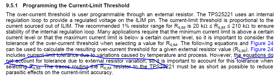

I have two questions.
①Does following formula include temperature characteristic?
②Calculation results which used above formula do not match the values of the electrical characteristics as below table.
Especially the smaller value of the IOS has big difference from calculation result.
In the case of RLIM=210kΩ, the calculation results (227mA(min)/261mA(nom)/294mA(max)) which calculated from above formula have big difference from the values of the below table.
Which one is correct?
    The table you post is the real test parameters.
    The formula above is the design formula includes the tolerance caused by temperature and process but not include the resistor tolerance.
    You are sure can refer to the fomula above to choose the current limit value.

  • Thank you for your answering my question.
    I understood that the formula includes the tolerance caused by temperature and process.
    Assuming that the value of the table is the real test parameters, are there cases in which the current-limit-function works outside the range of caluculated value using the formula?
    227mA(min) / 261mA(nom) / 294mA(max)   max-min=67mA : calculated value, R=210kΩ±0%, includes the tolerance caused by temperature and process
    225mA(min) / 261mA(nom) / 297mA(max)   max-min=72mA : calculated value, R=210kΩ±1%, includes the tolerance caused by temperature and process
    216mA(min) / 261mA(nom) / 309mA(max)   max-min=93mA : calculated value, R=210kΩ±5%, includes the tolerance caused by temperature and process
    210mA(min) /                       / 370mA(max)   max-min=160mA : the real test parameters shown in the table, RILIM=210kΩ, -40℃≦Tj≦125℃
