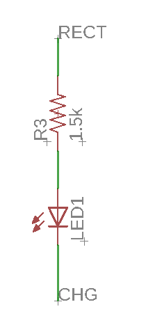

    I tried with just a plain red LED which seems to light up intermittently. I am seeing decent gain and coupling in the coil, so the tuning did seem OK.
    I also noticed that I tied the LED to the RECT pin instead of the out pin but this wouldn't cause an issue like this would it?

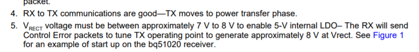

     From the test and troubleshoot manual from TI I was able to find the following:
    I am only getting about 5 volts at the RECT. I tried some other coils as well.
    The following pictures are form the scope:
    Vout on Start up:
    Vrect on startup:
    What could cause the voltage on Vrect pin to not be sufficient?

    Thank you so much for your prompt reply. I could send you a pdf of our pcb layout. The C14 AND C 16 are just output capacitors meant to smooth out the Rect and out voltages. I didn't think this might have that much of an effect on the system. In fact after extensive troubleshooting yesterday our design even matches some off the shelf chargers by samsung and adafruit etc. Only difference being current output, we have 1 amp, the others are only configured for 500-600 ma. Here is some weird:
    I tried multiple coils with this design and multiple off the shelf chargers as well. They all seem the behave the same way.
    The coils are all recognized and transmitter transmits power, I can see the comm packets on the Rect output as the manual shows. However, the transmitter is only transmitting at roughly 10 volts pk to pk which our receiver sees. This is done at 144-146 kHz constantly. This signal is common across RX and TX coils. When this signal is rectified internally etc. It becomes 4.5 volts at the Rect pin and consequently only 1.8 bolts on the Out pin.
    When I tried a different off the shelf Samsung Receiver based on this chip with a design matching us, with minor differences in capacitance values about 10 NF we see that the transmitter transmits at 20 volts pk to pk. This is why the capacitors should be sized for 25 v minimum.
    From my understanding (I could be totally wrong here), the internal DRC (dynamic rectifier control) is supposed to send error packets to the TX to increase voltage until the output is at par. This does not seem to be happening.
    How would we even go about correcting/compensating something like this. It's really odd that communication and power contracts are established but the output is stuck at less that 2 volts.
