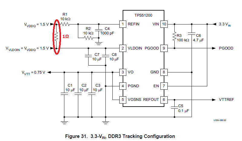

My customer apply TPS51200 for DDR3. SO, they was facing the inrush
input current on VLDOIN & outout on VO pins. They apply TPS51200 for DDR3.
They tried to add 1 ohm resistor between VLDOIN and VREF pin, then
the input peak was reduced from 2.75A to 0.688A.
So, I would like to confirm followings;
1. Is it no problem on this kind of usage for TPS51200?
2. If no problem, How much voltage drop should be estimated on VLDOIN
pin?

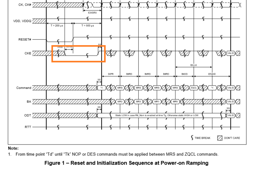

3. Personally, I think Trcking Start-up and shutdown is not so good for
DDR. Because DDR has the initialization time inside.
S3 and pseudo S5 is better to escape from unknown VTT setting
inside of DDR. How do you think about my thinking?
