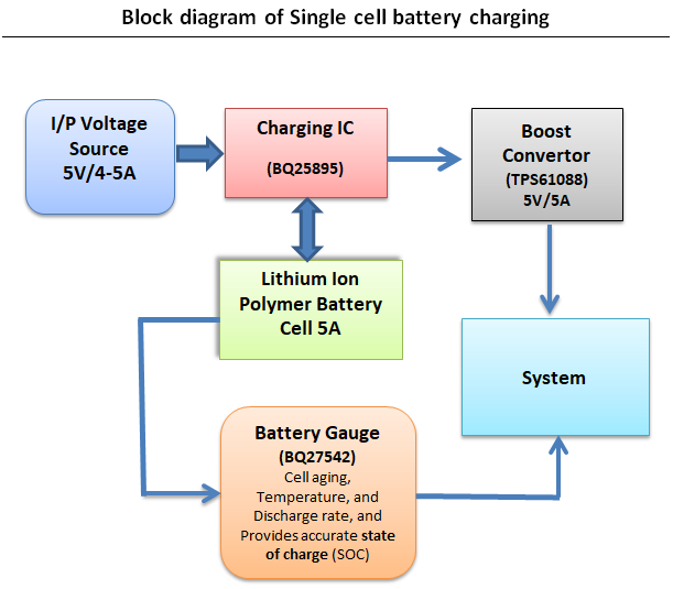

  • Hello Jeff,
                    BQ24610/6 there is no any software control provision in the system like I2C controllable to adjust system parameter by software
    Please find the attachment for system block diagram
    TPS61088 is used for to avoid system reset when adapter supply is off and battery takes 30mSec to supply power to system(To avoid Switch over time because of that system Reset)

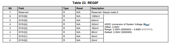

  • Hello Jeff,
    How I get output 5V ...? VSYS provide 5V/3A Output, if yes what is the register setting ..?
    Rahul Surawase
  • Rahul,
    The above register is read only for the ADC.  SYS will never be regulated 5V.  The charger only regulates system to MINISYS when V(BAT) is below MINSYS (REG0x03b1:3) = 3.0V-3.7V. The highest voltage SYS reaches, as the battery charges above MINSYS, is  BATREG REG0x06b2:7 = 3.840V - 4.608V plus 150mV.
    Jeff
  • Rahul,
    The overall concept is valid, except, as I previously mentioned, the BQ25895 cannot provide 5 A output from 5 V input due to 3.25A max input current.  Even with only 3.25A input, my concern is still for the heat sinking of BQ25895 at max output power.
    BQ24773 is a charger controller with external FETs that has I2C communication.
    Jeff
