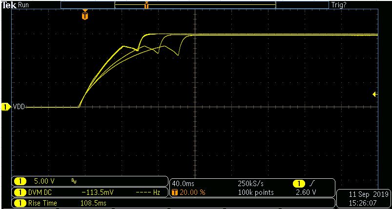

    Right now we have C_REF = 220nF, C_DD = 1uF + 100uF and C_SS = 15nF. The feeding of VDD pin has also altered so it is higher in general (added turns to the transformer) and is limited to 15V by a zener diode. So everything is much better now but I still see some phenomenon which I can't understand.
    I found out that the charging of the VDD is dependent on temperature. And the ramp is not constant, so the charge current appears to change depending on on temperature and VDD voltage. See attached figure. In the figure is just the temperature change seen, VIN is connected to an external supply at approximately 24V.
    Higher temp. ==> slower charging ==> sometimes is the final voltage below 12.7V leaving the controller in a non starting state.
    Should't the J-FET just fill up the VDD capacitors with as long as the VIN voltage is sufficient?
    VDD reaches 12.7V and starts charging SS etc. VDD falls and then start conditions are fulfilled. It starts switching and VDD rises to 15V.
    Another phenomenon is that the VDD falls due to the weak supply in a no load condition, but it takes 2.5sec after start. Any clues what causes this time constant? I expected this to happen right after the start procedure.
    Best Regards / Daniel

    BUT to my embarrassment did I find more consumers on VDD, or rather our AUX_SUPPLY, which probably sinks the voltage by its current consumption. (Too many pages in the schematic apparently... :-)) When these consumers were removed did the design start as intended , even in the conditions where we had problems before.
    We are still testing if this is the root cause to the behavior in our design and it looks promising.
