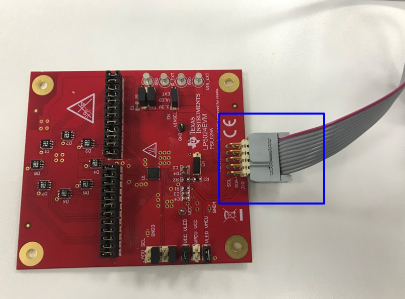

Q1: What’s the right direction when USB2ANY module is connected to the LP50xx EVM?

  • Q1: What’s the right direction when USB2ANY module is connected to the LP50xx EVM?
        Fig.1 shows the right direction when the USB2ANY module is connected to the LP50xx EVM. Please pay attention to the part marked in the blue block. For more details concerning hardware setup of LP50xx EVM, please refer to the corresponding user’s guide. I provide a link here to download the user’s guide of LP5024.
    Fig.1

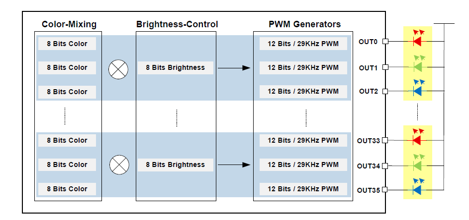

    Q2: What is the purpose of color mixing? Is it similar with brightness control? Why there is no individual brightness control for each output channel?
        Color-mixing means that different color can be decomposed of different proportions of RGB.  You can configure the proportions of RGB to get desired colors. The proportions of RGB are controlled by configuring the brightness of each R,G and B LEDs.
        The PWM duty ratio control is related to the brightness of each channel. As shown in Fig.2, PWM duty cycle is defined as the product obtained by multiplying the color-mixing register value (Outx_color) by the related intensity-control register value (LEDx_Brightness).
         Actually brightness of each output channel can be controlled by the register OUTx_Color individually. However, the value of OUTx_Color will affect the proportions of RGB. When color is fixed, the independent intensity control (LEDx_Brightness) is used to achieve accurate and flexible dimming control for every RGB LED module. Besides, OUTx_Color register can be used to adjust the brightness independently for single color LEDs.
    Fig.2
