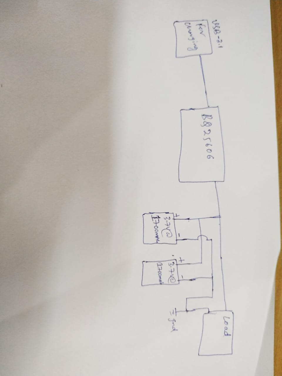

We are using two lithium polymer battery in parallel combination each one has a capacity of 3.7V @ 1700mAh.
And we are planing to use bq24103A IC from ti.is it ok to use please confirm.
and also we are charging from USB.
or suggest me any better ics from ti.

    Parallel Li-Ion batteries self balance.  BQ24103A will be okay to use for charging although charging a 3400mAh battery with only 2-A will require close to 2 hours for full charge.  If your USB source can provide 5-V, 3-A, you might consider changing to BQ25606 3-A, all integrated charger.

  • Hi Jeff,
    Thanks for the support.
    Can i use BQ25606 for 3A charging. and  we  are connecting two parallel 3.7V@1700mAh Batteries for this configuration is it ok to use BQ25606  iC.
    Please confirm. below attached our block diagram.
  • Ashok,
    Your block diagram should work.
