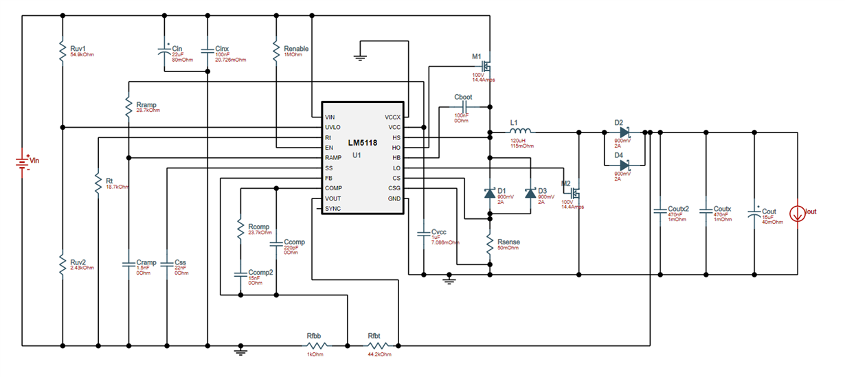

This the is WEBench circuit that I based my design on:

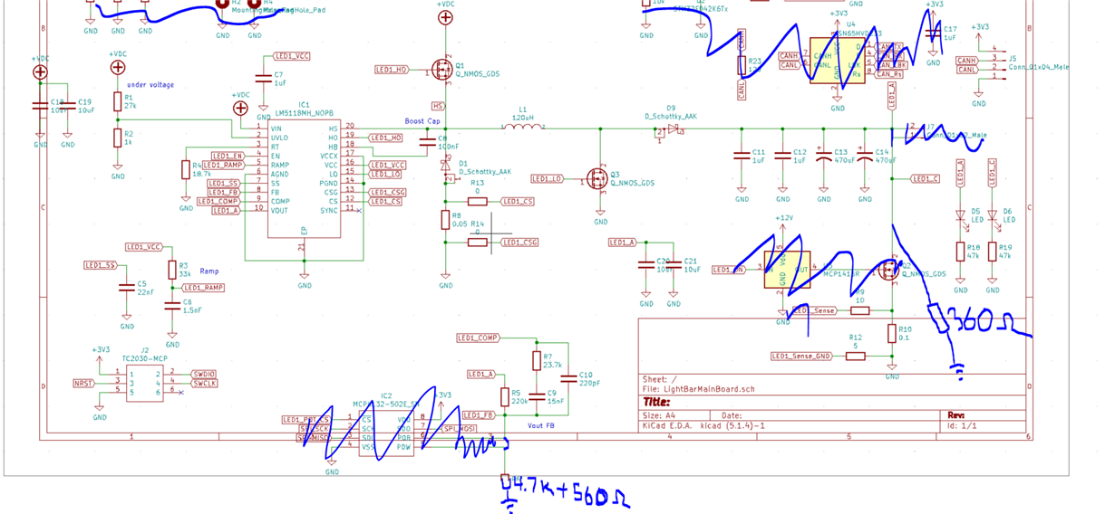

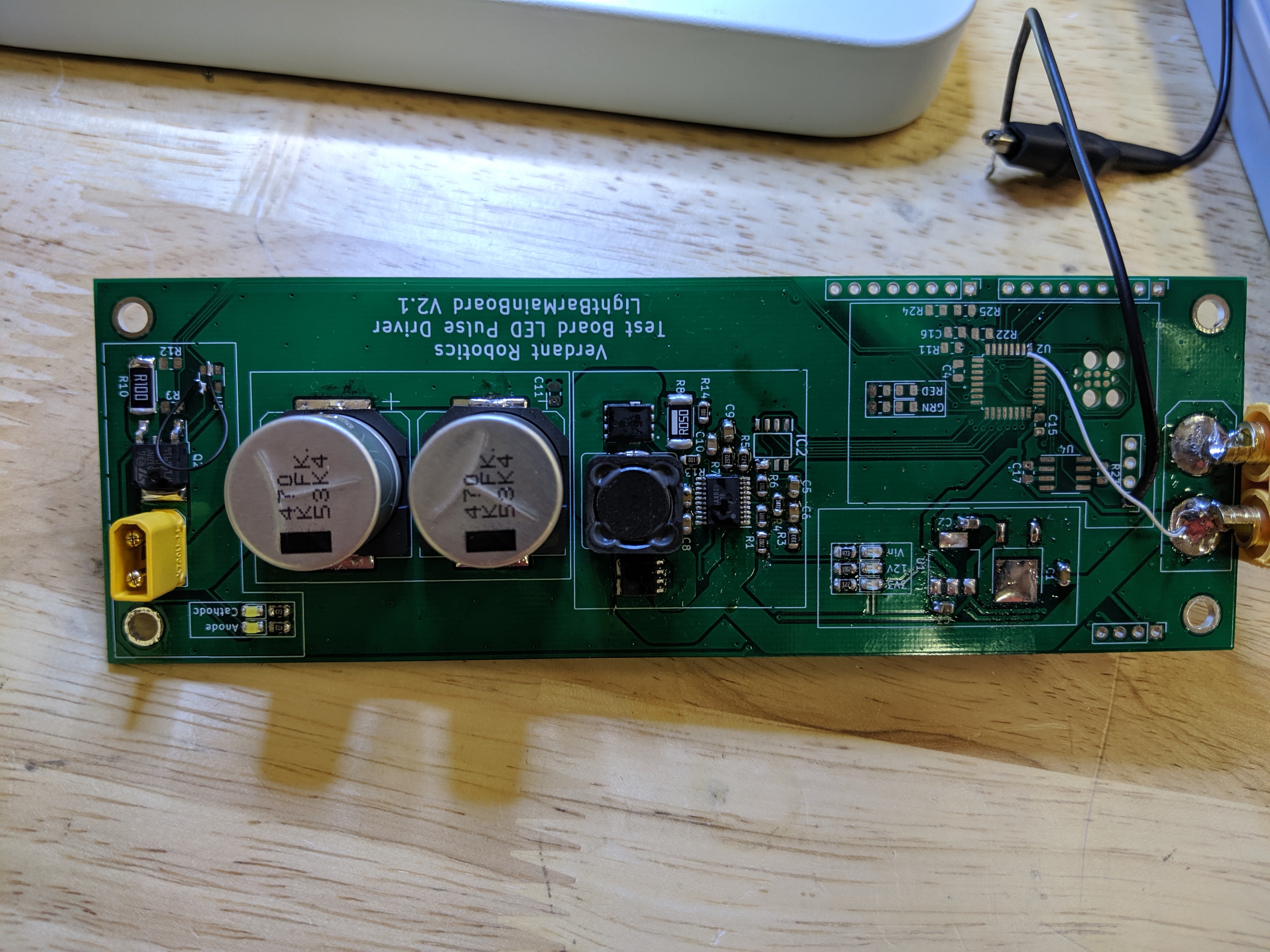

This the circuit that I have designed and implemented on PCB.

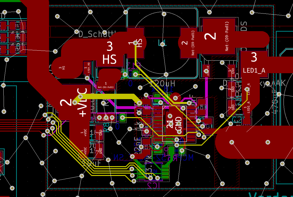

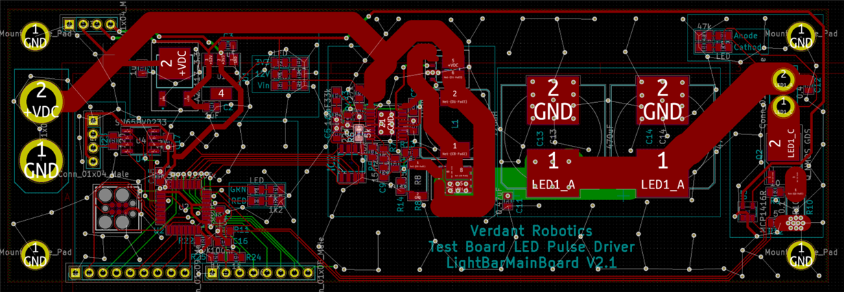

This is the PCB Layout:

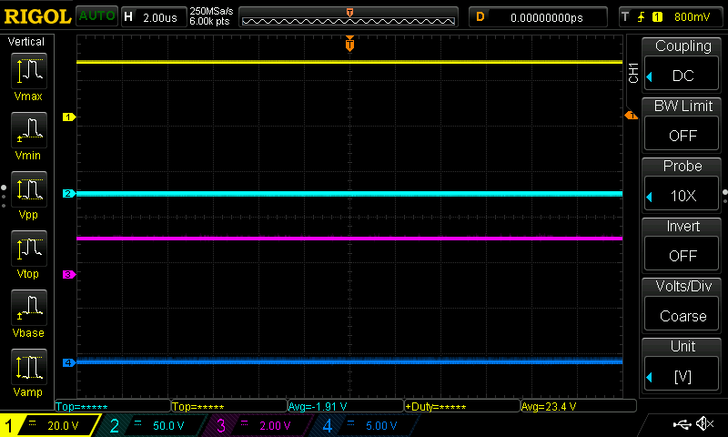

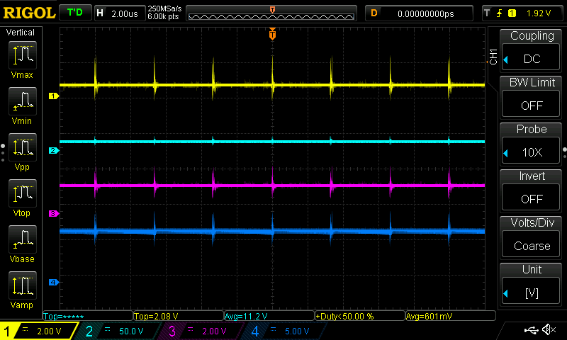

    Got your measurements along with a few more.
    I did a today measuring the Vout, EN, UVLO,VCC, and FB pins.
    Vin: 48V
    1MOhm from EN pin to Vin.
    220k, 10k fb resistors which should give an output of 28.3v based on a vref of 1.23
    Picture1:
    Steady State
    Load: (47k + led)||(940uF)
    Yellow: En, Blue: Vout, Magenta: UVLO, Darkblue: VCC
    Note: good so far

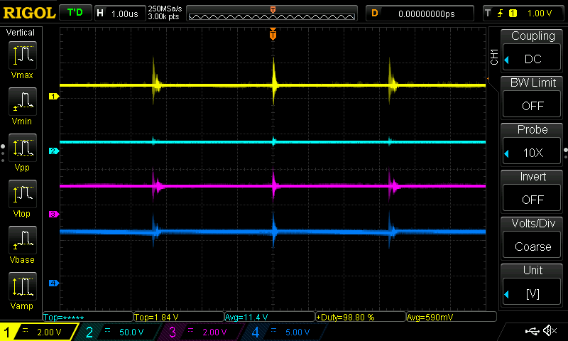

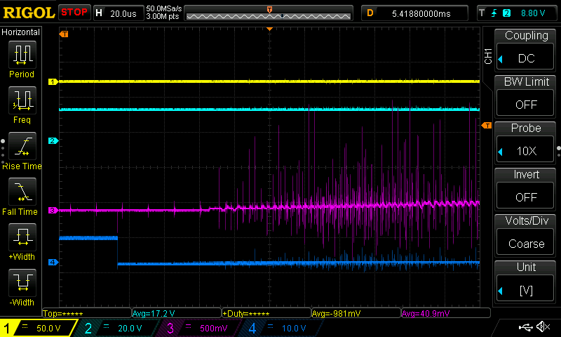

    Picture3:
    On Startup
    Load: (1k)||(47k + led)||(940uF)
    Note: there is substantially more noise now that I added the 1k resistor across the output

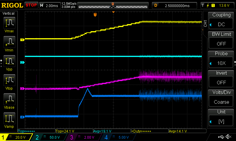

    Picture4:
    Steady State
    Note:The output here measure to 14V with a multi-meter, this made me suspect that there is something wrong with the FB loop. So I started measuring the FB pin instead of EN in the following measurements

    Note: The FB pin has some horrible noise, other lines are also pretty bad. Im wasnt sure if this was because I was measuring the ground plane too far or there is actual noise so I soldering a ground wire to the AGND pin and started measuring ground from there.
    Picture6:
    Steady State
    Yellow: FB, Blue: Vout, Magenta: UVLO, Darkblue: VCC
    Note: Moving GND did not work, this is the actual noise on the FB pin...

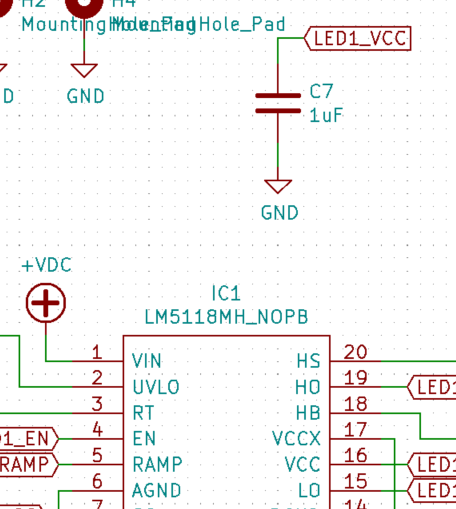

  • Hi Danny,
    I took a second look at  your schematic and it looks like the VCC pin is is missing the capacitor from VCC to GND. I see it in the layout, what is the value of this capacitor.
    Thanks for providing the waveforms, based on these it looks like there is an issue between unload and a loaded condition (when the 1kOhm resistor is add). Is this a two layer board? Typically a 4 layer board is used to help shield sensitive signals with a ground layer.
    In picture 2 it looks like the output voltage is already up before the EN pin is pulled high. What does the start-up look like when the output voltage is completely discharged?
    Also please try replacing the feedback resistors with the values that were calculated by WEBENCH. The LM5118 has a voltage error amplifier and changing the top feedback resistor will change the loop compensation.
    -Garrett
  • 1) VCC has a 1uF cap on it.
    2) This is a 2 layer board, thus it may be an issue with interference.

    4) I have replaced the resistors with the calculated WeBench values and replaced the capacitors with the right values as well. The values are exactly the same as the picture below:

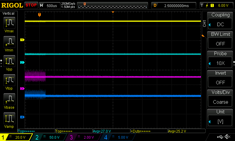

    Here is a measurement I just took on startup:
    The output load is (47k + led)||(940uF)
    Yellow: Vout    Blue: En    Magenta: FB    Darkblue: LO
    The Vout takes about 2 seconds to reach 52.5v
    Here is the same measurement except I attached the 1k resistor across the output. This time the output does not reach 52.5V only to 13.4v
  • Something is very wrong with the FB. The FB voltage does not reach 1.23v when I have the 1k load across the output.
    With the smaller load the output voltage reached 52.5v and the fb pin is sitting at 1.23V as it should be.
  • At 37Vin and a 500Ohm load the FB pin drops to 220mV and the output drops to 9.3v compared to 13.4v at a 1kOhm load.
  • Hi Danny,
    Check the UVLO pin. If the UVLO pin is getting pulled low then the LM5118 is entering hiccup mode.
    Based on the amount of noise on the FB pin I think it would be good to implement a 4 layer board to help minimize the noise.
    Garrett
  • Got it,
    I'll re-run the board with 4 layers and get back to you.
    UVLO seems to be fine
  • Danny,
    Sounds good. If you have any other questions please create a new post. I am closing this issue.
    Garrett
  • SOLVED!
    I ran a 4 layer pcb and got the system to work with a 360Ohm load @ 52.5Vout and 36-60Vin
    WOOOHOOO super happy with this working! thanks for all the advice!
