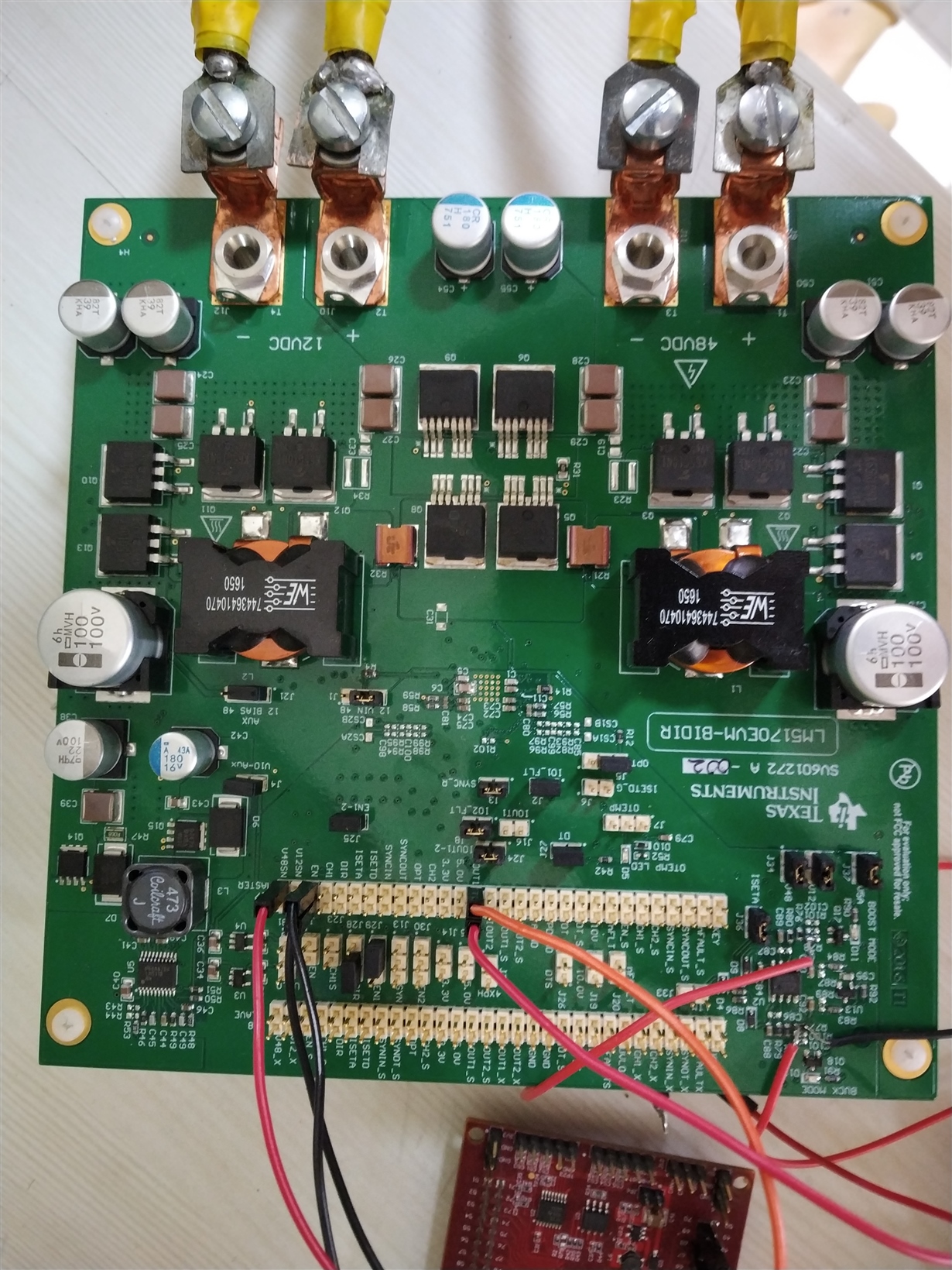

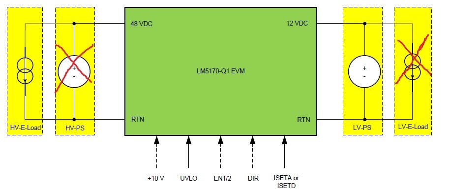

I am trying to test the EVM module for normal boost operation. In the test procedure, it is written that HV-PS is required for start-up in boost mode, if not MOSFET breaker should be shorted. How to short? I have seen another similar thread where copper foil must be used to short.
Whether I should solder as shown in the above image?
  • Hi Praveen,
    Thank you for your interests in the LM5170.  You are right, the two exposed pads are reserved for the shorting of the breaker FETs.   Please also do the following, to operate the EVM.
    1. Soldering 100k to R4 (factory default: not installed).
    2. Close J1 jumper to "12" side.
    3. Close J21 jumper to "12" side..
    4. Close the following jumpers: J2, J3, J4, J8, J34, J35, J36., J37
    5. Colse J5 to "OPT" side.
    6. Close J28 to "DIR" side
    7. Close J29 to "J29" side.
    8. Close J25 if you want to run dual phase.  Keep it open if you just want to run the 1st phase.
    9. To adjust boost output voltage, change R22.
    Good luck in your evaluation.
    Youhao Xi, Applications Engineering

    How much current (max) will pass through the MOSFET breaker shorted wire? (shorted for normal boost operation)
    Regarding OVP, cant I apply above 22V supply at LV side during boost mode?
  • If  you solder a piece of copper file, you can easily pass the EVM rated current of 60A.
    Yes you can, OVPB is ignored in boost mode.

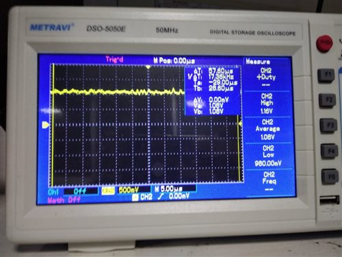

    From previous discussions, I have made all the required changes and tried to run the EVM in normal boost mode with a DC supply and a motor load. I have to maintain the output voltage at 48V as of now.
    DC Supply at LV side: 24 V and current limit 15A
    Motor: 48V,  no-load current: 6A (I didn't fully load the motor, running at no-load, so minimum current )
    1. I have made the necessary jumper changes as mentioned earlier
    2. Shorted the MOSFET breaker using a wire (20A current capacity) (copper file/foil is not available at this point)
    3. Connected small wires at R77 and R78 for regulating the output voltage, and at the ground.
    4. R4 100kOhm connected
    5. VDAC max is 3V and Radj is 14kOhm.
    The output voltage at the HV side is the same as the input voltage (LV Side: 24V) during the boost operation. Also, the boost mode LED doesn't glow.
    I am not able to find out the fault. Can you point out possible mistakes to debug?
    Below image is the voltage at R77 node.
    Note: Instead of DAC and Radj, I have also tried directly giving Vref at R77 node.
  • If the light is not on, you may lose the +5V bias.  Check the +5V bias rail.
