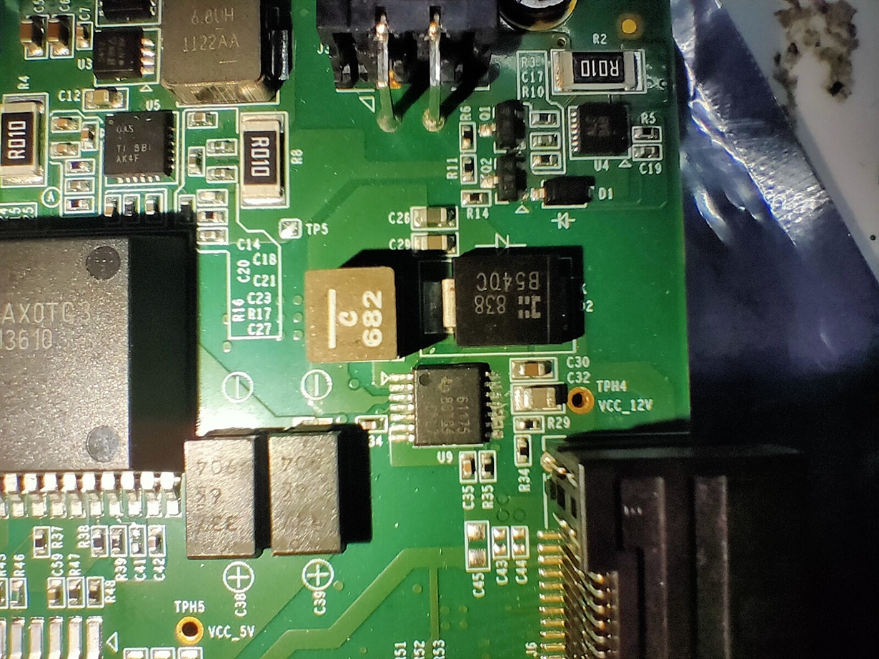

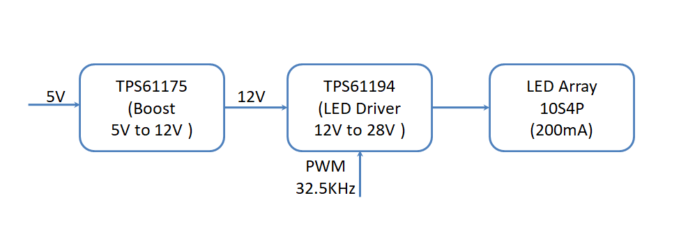

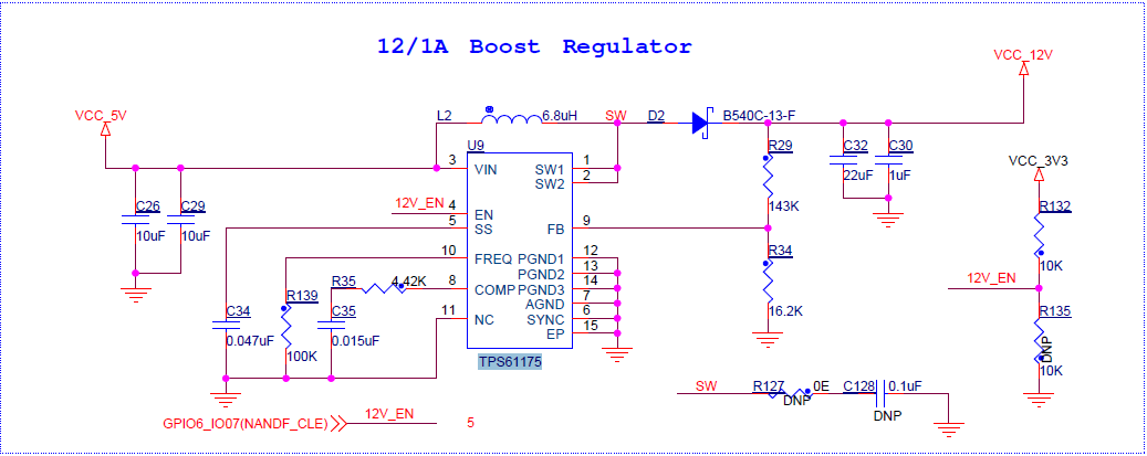

I am using tps61175 in my design. I am using this regulator for 5V to 12V conversion. I am using this regulator to drive an LED driver circuit for an LCD backlight.
The LCD backlight will be controlled by a PWM signal. So the load of the regulator will be continuously on and off.

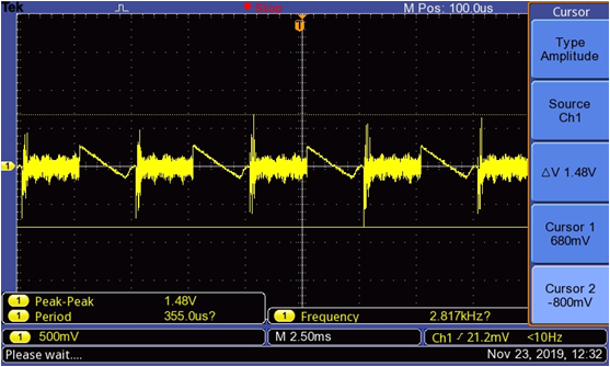

I am getting an output ripple voltage around 1.5V  when I am using PWM.

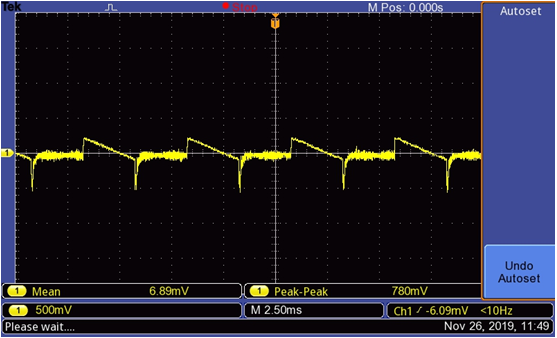

And I am getting 370mV for a continuous load.
Is there any way to reduce the ripple voltage on output side as I have to test the system for RE and CE.
