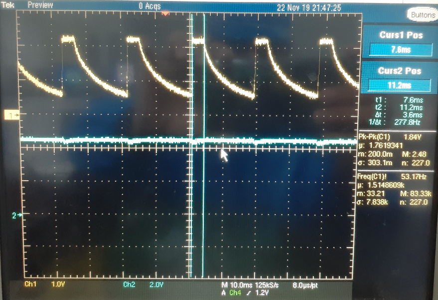

It was observed that LDO output was at 2.2V for ~4mS and then starts decaying. LDO output is shown in CH.1 and PFI input is shown in CH. 2.
(As mentioned earlier, I am using the default values - so I was expecting 1.8V with 2% tolerance.)

    This is not an oscillation, which would happen at a much higher frequency. What you are seeing is a power-up sequence, followed very quickly by a power-down sequence. It does not make sense that the DCDCs are all 500mV and they never fully go down to 0V, but it is still clear to me from the LDO1 waveform and the timescale (10ms/div, 20ms/div) that the PMIC is trying to power-up, detecting the incorrect voltage for every rail, and then powering down.

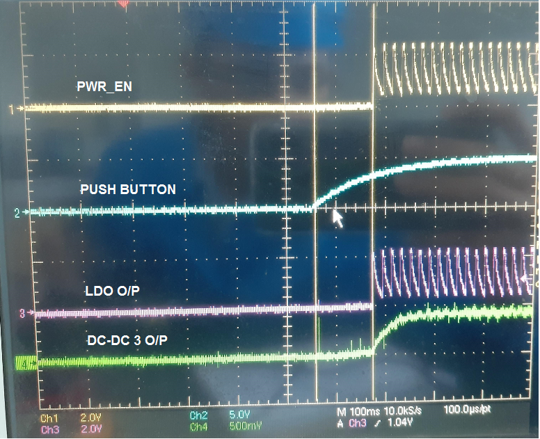

  • Aravind,
    During first power-up sequence, please measure 4 channels on oscilloscope:
    • PWR_EN
    • PB
    • LDO1
    • DCDC4
    It appears to me that LDO1 is causing the problem. You see that VLDO1 = 2.2V, but it should be 1.8V and the STRICT bit is set to 1b by default.

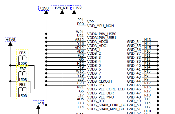

    The question is: why is LDO1 too high? What happens when you remove the connection from +1V8 to +1V8_RTC (R67) and measure at the +1V8 net (TP115)? In your original thread, you said:
    Aravind Sridharan said:
    Output load on the DC-DC converters were removed and the same above mentioned behavior was observed. But, LDO was connected to AM4372 RTC section, as we didn't have 0ohm in the LDO line.
    But this does not make sense to me. If 0-Ohm is removed, LDO is not connected to +1V8_RTC anymore.
    It is very hard to say if LDO1 > 1.8V before or after DCDC4 = 3.3V, as you did not provide a scope shot for this yet. But it is my assumption that, without any other external DC-DCs or LDOs on the board, that LDO1 must be 1.8V exactly for 1-2ms before DCDC4 turns on. Somehow, when DCDC4 turns on, it is creating a leakage path through AM437x from 3.3V to 1.8V due to the fact that DCDC5 and DCDC6 are not used. It would be easier to determine after looking more closely at the scope shot I requested.

    It makes more sense to keep R67 populated because this is the supply for RTC rail #1. The only way to test LDO1 with no load would be to cut the trace and I don't know if that is possible on your PCB.
    This brings up another point I noticed on the schematic: CAP_VDD_RTC does not receive power from anywhere. The schematic shows R314 is DNI, which is the connection from CAP_VDD_RTC on AM437x chip to +1V1_CORE rail.
    I do not know the impact of this from the AM437x, but it is a surprise to me that this rail has no power, because it is RTC rail #2 (the second rail to turn on when DCDC5/6 are used).

    Please find the scope traces.
    1. When Power Enable is pulled to 1.8V_RTC. Please note that the channels have different voltage scales.
    2. When Power Enable is pulled up to 5V input. Please note that the channels have different voltage scales.

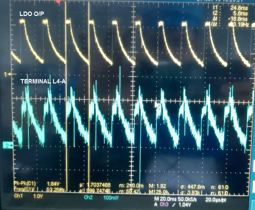

    3. After removing inductor and probing in L4-A pin. So, this shows that PCB layout is not impacting LDO behavior.

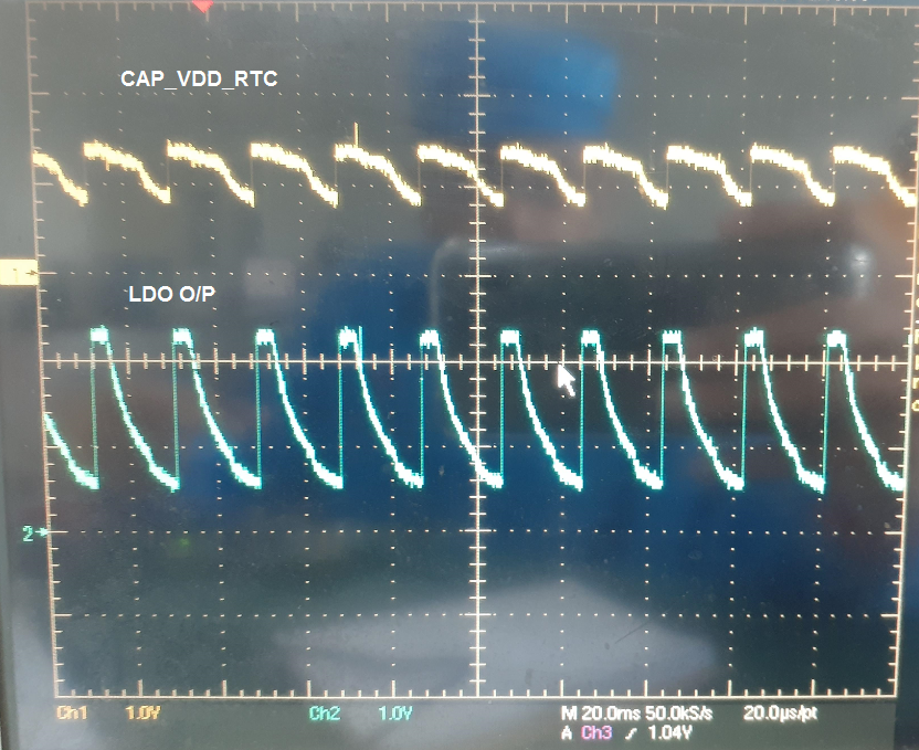

    4 (A) Reg: CAP_VDD_RTC Power: I have connected RTC_KALDO_EN to GND through R68. So, R314 was kept as DNI. Below is measurement from CAP_VDD_RTC pin
    4(B). When the CAP_VDD_RTC is powered from +1V1_CORE (by populating R314 and disabling RTC_KALDO_EN).
    Same LDO behavior was observed.

    Most of these scope shots say "DC-DC-3 O/P", and one of them says "Terminal L4-A".
    When don't any of them say ""DC-DC-4 O/P", as in the output pin of DCDC4?
    Maybe ""DC-DC-3 O/P" is a typo and it should say 4 instead of 3. I cannot tell where you measured so I would like to confirm.
  • Brian,
    Sorry, it was a typo error. I should have mentioned it as DC-DC-4 O/P
    DC-DC-3 O/P in above pictures are 3.3V output rail, measured at Pin 15.
    Terminal L4-A measurement, is after removing the inductor of 3.3V converter and measuring at L4-A, Pin 13.
