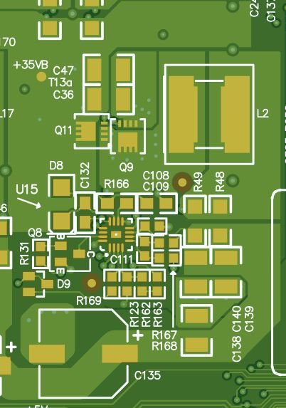

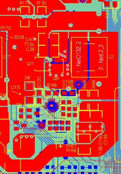

The board layout is as per the guidelines and a via is used to connect the pad under the IC to the 0V plane for cooling.
The power supply circuit and PCB layout is below. Note the PCB is 4 layer with the pad connected to the 0V plane.
What is the likely cause of the damage to the IC?

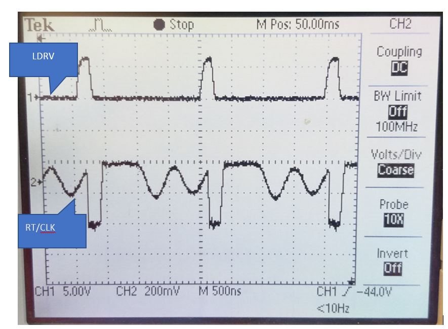

    At the mean time, would you please show us some key waveforms like LDRV, SW, and VOUT?
    Youhao
  • Hi Youhao,
    Thanks for your reply.
    Below are some of the waveforms. The input voltage is about 25V and the output about 35V. The output current is about 200mA. The IC is running at about about 60C - 70C (rather hot). A good chip runs at about 35C.
    Hugh
  • Hi Hugh,
    Thanks for the info. The waveforms look normal.  You circuit seems running in deep DCM.  You may consider to increase your inductance to move the operation into CCM for higher efficiency.
    I reviewed your layout and it does not look bad, although you may add more vias for the input capacitor ground polygon to lower the ground impedance between the input and output.
