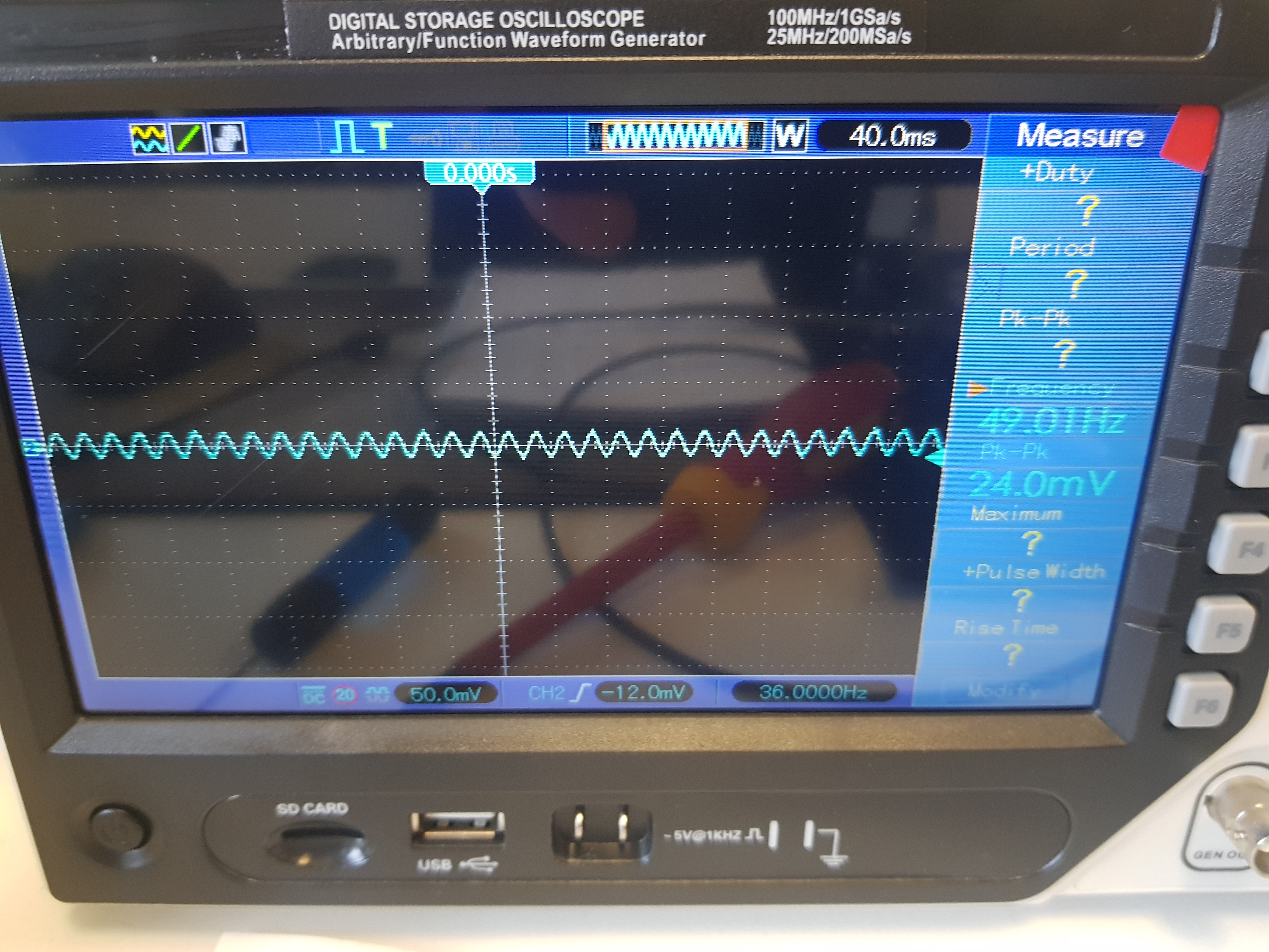

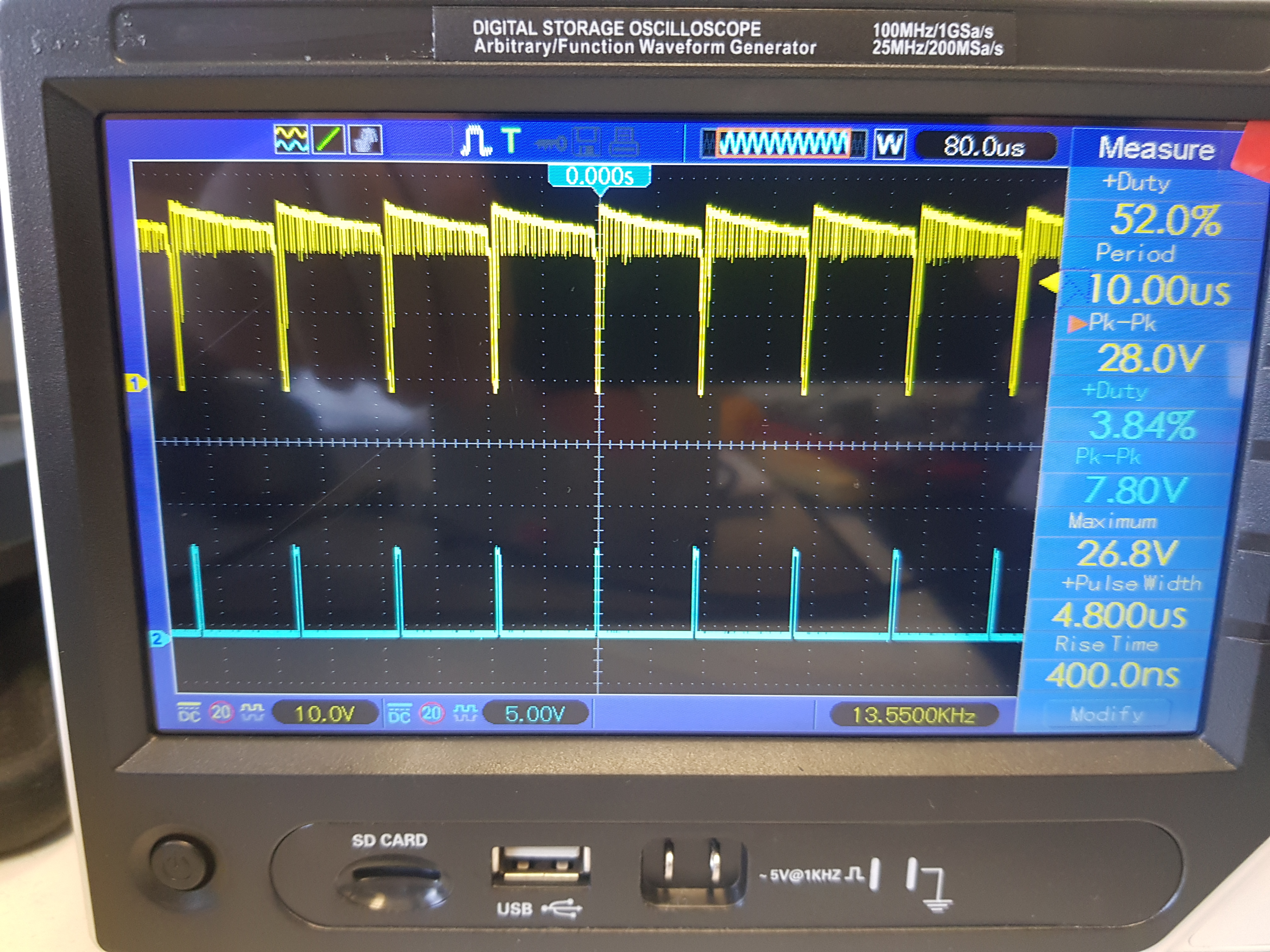

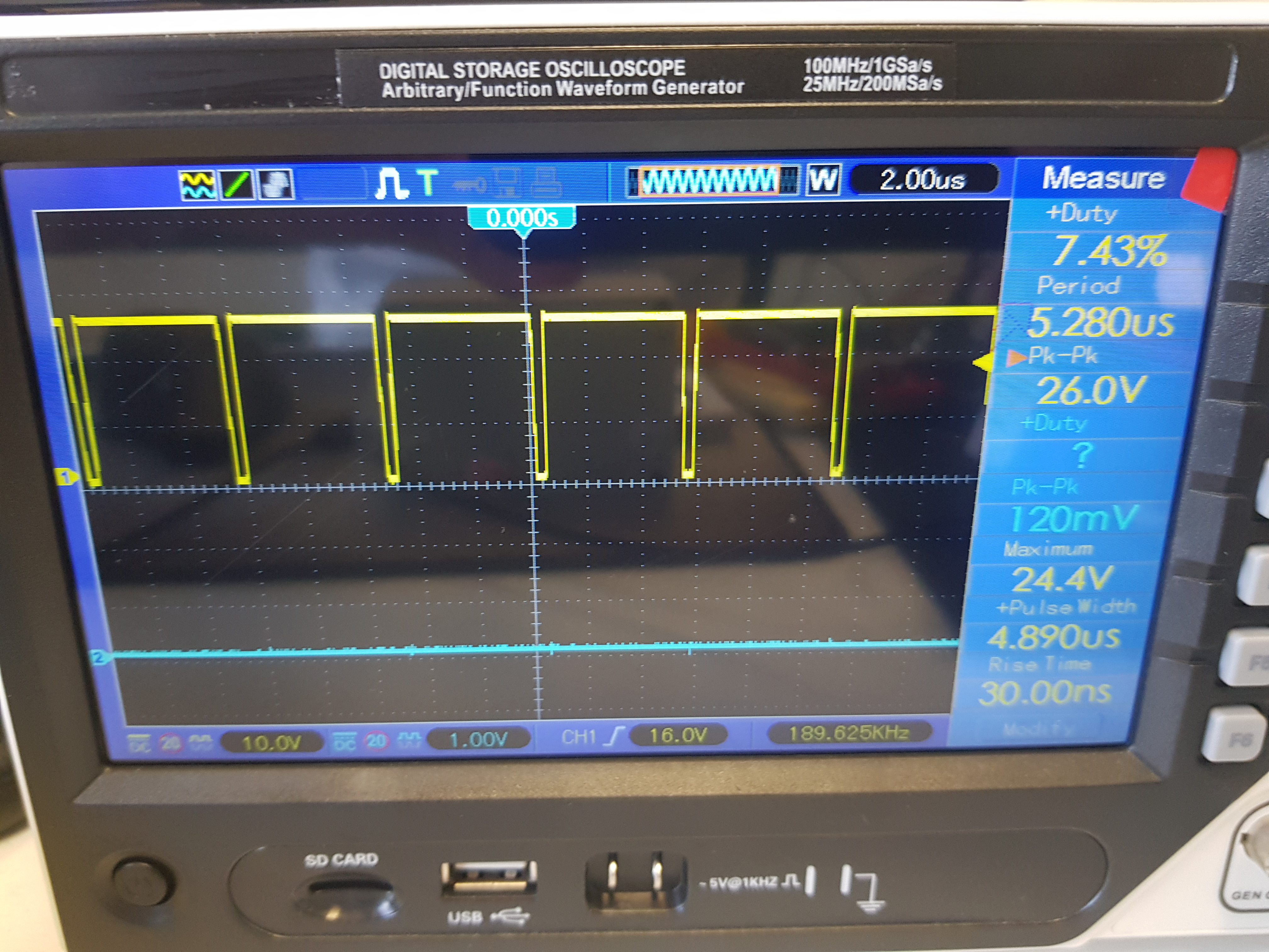

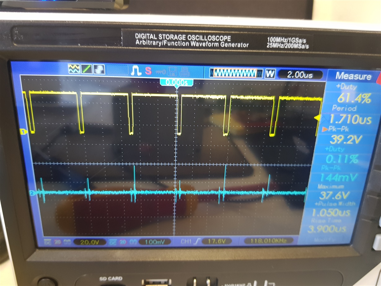

I can provide wave forms on request as well, just let me know which ones would be most useful.
