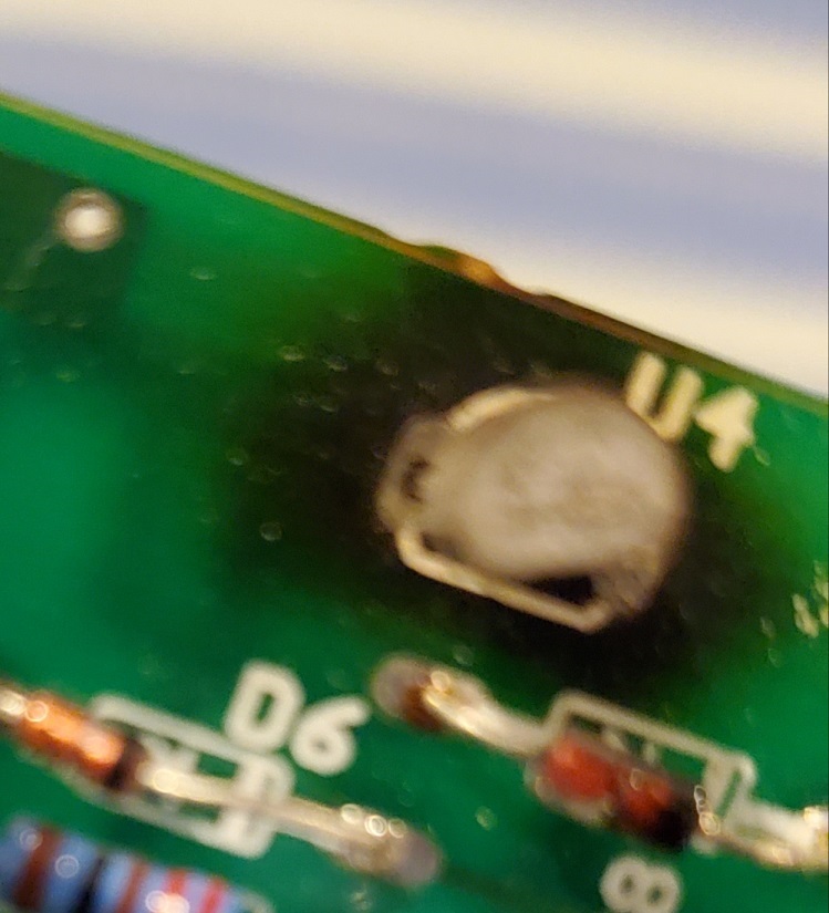

I have been experimenting with the reference design TIDA-00652 , I have seen few issue over period of testing . I am facing two issues.
1. The SMPS does not go in protection mode even if the draw on the output is over 30watts, so over 24Vdc at 1.25 AMP, I have checked the values of the resistors and R2,R3 and R6 have 1% variation in the values. Similarly R16 and R17 are 191K, with 1% variation.
2. The BaiseHV circuit has over heating issues and fries when the smps draw is over the specified values.
What may be the issue? there circuit is constructed using exactly the same components as in the BOM.

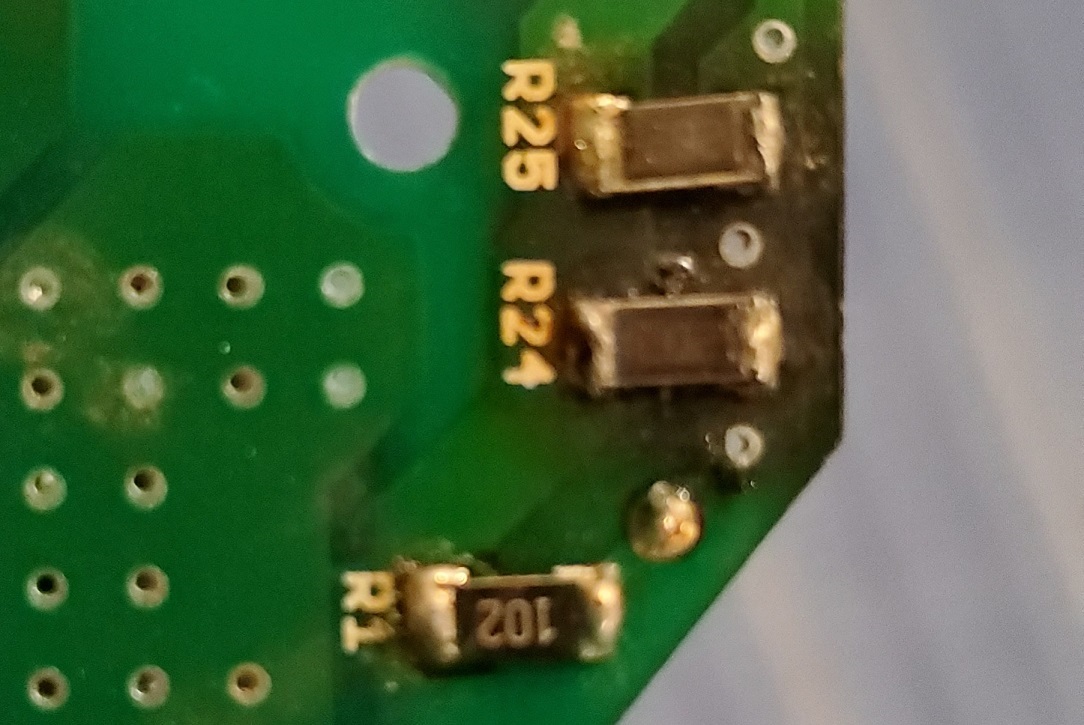

    Thank you for your reply.The design document says the MAX output current in 1.2A, so does this mean that there can be over draw of current of 1.4 to 1.5 Amp and the power supply can sustain the draw over long period of time?
    The BaisHV circuit is suppose switch off once the power supply is on mode , but I have seen that R1 ,R24 and R25 have heating issue such that the pcb around them turn Black over a period of time. Also MOSFET U4 shorts out  after few months of use and usually it burns on start up. I have tested the circuit for standby mode for long period , the circuit never failed, the burning of components is only after the the ciruit has been over loaded few time.
    The components are exactly as the BOM. The voltages at every point on the BaisHV circuit  is checked and is as per the design.
    I have Designed and built a PCB based on the TIDA-0065 .
    The photos will give an idea of the effect on the Bais HV circuit. this is on most board after use and after draw over 1.2 Amps , ie : total wattage exceeds 32 watt on watt meter connected to the input AC supply . if the boards are run at lower wattage of say 28 to 29 watt, board dont have this issue.
    I have kept the boards on standby for over 100 hours   and never seen the components burn, this test was performed to confirm the components can withstand prolong use of baisHv circuit.

    The heating of main components (MOSFET and inductor etc) is  not a issue these are the components which should heat up on the drawing current. The baisHV is only used when the power supply is in low power mode.
    I need to know why the BaisHV circuit has this issue, it should switch off when the power supply is actually on and current is drawn, so this ciruit should not heat up and burn .
    I do not need more current, I am trying to understand why this happens.
    Also since the power supply can power can be driven to less than 30watts , I should be able to run upto 29.5watts with the designed circuit .
    The issue is not the actual circuit but the high voltage (power up and standby) power supply circuit, there is nothing except a DRV10983. So the current draw is very low.

    from the information you offer, I suggest you can do below test to find why there is over temperature issue on HVbias circuit.
    • when the ouput power is below 30W, for example at 25W, because there is no failure at HV bias circuit, at this conditon I suggest you can probe the current through U4 mosfet, suppose the current is I1.
    • Try to increase the output power to above 30W, for example at 35W, because there is failure at HVbias circuit, you can also probe the current through U4 mosfet, suppose the currnet is I2.
    the current I1 should be less than I2, because I2 makes U4 and resistor over temperature failure. At this time, you can try to increase the secondy turn of the inductor.
    The aim is to higher the voltage at signal MAG in the circuit, and always let HVbias bypass.
    My guest is during over power conditon, HVbias charges VCC cap V12 all the time, and this makes the resistor and mosfet over temperature.
    Let me know whether it make sense.

    Thank you!! I have used your test procedure and figured out what was happening with the MAG voltage, I have designed the startup circuit and current through U4 drops from 5.2mA (at start up and standby condition) to 0.01mA at around 4 watts of output current draw. I have been trying to upload the waveforms you asked for but there is some issue with the upload page, I will try later again.
    Thank you very much for your time , it has been great help in understanding the issue.
    Thanks and Regards
    Dinar
  • Hi Dinar.
    Thanks for your update and happy to see that we have find the root cause. please allow me to close the post.
