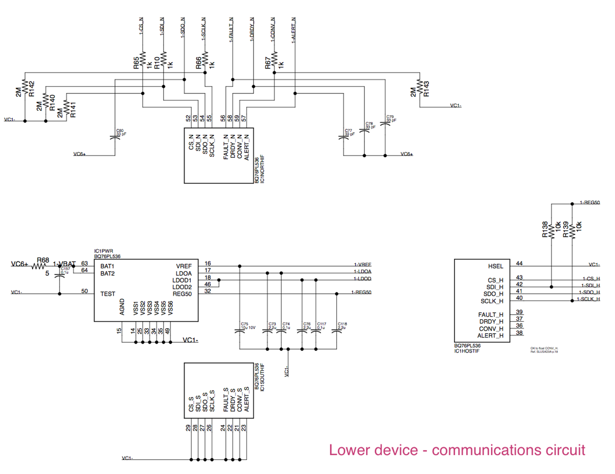

We are having a communication issue with a PCB based on the BQ76PL536A. A short time after the stack is put in SLEEP mode, the upper three devices stop replying to SPI communications. The system consists of four BQ76PL536A devices controlled by a C2000 host processor. A reproducible test case is included.
The system properly discovers, configures, and measures all the BQs. However I am unable to communicate with all but the first BQ in the stack after putting them into sleep mode, this includes bringing the BQs out of sleep mode.
Below is a log of the communications between the C2000 and BQ stack. The first test has a long delay (0.5 seconds) after the sleep command which causes all but the first BQ to not respond to a read. The second test is the same except with a shorter delay (10 ms) in this case all BQs still respond.
The only action taken before the following communications is the discovery process that addresses the BQs. The devices have not been flashed with custom OTP configuration. Before each test, power is cycled to the BQ devices.
After devices #2-4 stop replying, issuing a stack reset (7F 3C A5 57) and re-addressing the stack does not cause the upper devices to respond. The only way to re-establish communications with these devices seems to be removing and re-applying power to them.

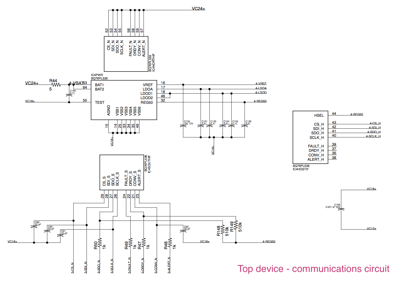

  • Whoops, sorry, I forgot to include the attachments. Here are the schematics and a logic analyzer capture of the communications in question.

  • Aaron,
    It's little hard for me to review the schematic.
    Can you send me your email address?
    I can provide email address for you to send your whole schematic? If you are okay with sending whole schematic.
  • Roger,
    I am working with Aaron on this project. I am doing the Software Aaron is doing the Hardware so we will both be answering your questions.
    The picture Aaron added to this second reply shows the state of the Serial (MOSI, MISO, CLOCK) and CS pins of the devices during both tests. Do you need more information than the picture provides?

  • Roger,
    I have your email address and will send along the schematic.
    The devices are on one PCB, with short traces between them (~1-2 cm). I have attached an image which shows the ground planes and spacing of the ICs. We have communicated about this layout before.
    This PCB has been modified to serve as a prototype, so devices #5 and #6 are not populated. North comm lines (SCLK-N, SDO-N, SDI-N, etc) have been terminated to VBAT+ of device 4.
    If the devices are not put in SLEEP mode, they work fine. As far as we can tell, they continue to work indefinitely. We can keep reading and writing to all devices until they are put in SLEEP.
    I'm not sure which signals you would like to see an oscilloscope capture for. What would you like us to measure?
  • Aaron.
    Here is your problem.
    I thought you guys said you were able to communicate with 10mS delay but not with 500mS in sleep mode.
    I don't think 10mS delay won't work either with your schematic.
    Reg50 is disable in sleepmode. You connected HSEL to REG50.
    HSEL is connected to GND for base but not slave.
    You need to connect HSEL to LDOD. Try this then it will work.
    Goto TI site and you can find the schematic reference in the datasheet.
    REMEMBER, REG50 is disable in sleepmode.
  • Roger,
    Thanks for your insight. That seems likely to be the issue - I'm surprised we've missed that for so long. We will modify and test our prototype.
    I think the error probably came from the following note in the datasheet (SLUSAD3A, p. 24):
    Designer Note: Because the LDODx inputs are pulled briefly to ~7 V during programming, the LDODx pins should not be used as sources for pullups to 5-V digital pins, such as HSEL and SPI(bus)_H connected pins. Use VREG50 instead, unless all programming is completed prior to mounting on the application PCB, in which case LDODx is a good choice.
    It seems like this note should be modified to mention that connecting HSEL to VREG50 will prevent the use of SLEEP mode!
