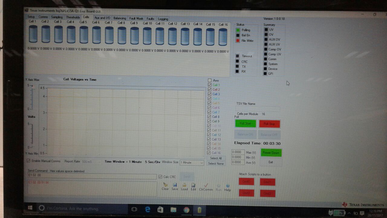

Hi All,
I am facing an issue communicating with BQ76PL455EVM using the manual command section. I am using a single evm board to monitor the voltages of 16 cells. I want to use the manual command feature to communicate with the board but I am unable to do so. When I enable manual command section I do not get the packets logged window which is seen in the datasheet of evm. Hence, I can only send commands(seen in red) but never receive a response from the GUI (which is seen in blue). I am able to poll the cell voltages using the Poll start button in GUI. My question is whether this is an issue of GUI version or an issue of the EVM. As the EVM is not responding to manual commands from the GUI, I have a doubt that it may not respond when I use a micro controller to interface the chip.
Any help would be appreciated.

  • Hi David,
    As of now I have tried the hex command 89 00 00 0D 00 with calc CRC box checked. Please find a few images attached. For the second image please ignore the command. I just wanted to show that packets logged window is not appearing in GUI.
    Rohan

  • Hi David,
    I tried mannual commands once again. When I gave a command to change no of channels in command channel register(addr 3-6), the register value was updated. However when I sent a command to read values, I did not get a response. Is this something I must be worried about?
    Rohan

  • Hi David,
    I figured out the error. I was sending the wrong hex code in manual command window (12 should have been 0C). Now i am able to write values to registers using manual command but unable to read.
    Hence I put up a scope on rx and tx. I am able to receive a response, just that it is not being shown on GUI. This is my guess as to what is happening.
    Moving ahead, i connected a microcontroller to the EVM. I have sent the same command which is for a power down from my microcontroller (hex code is 91 00 0C 40 crc calculated), but the evm does not enter into power down. I checked the waveforms on scope and waveform of microcontroller is exactly as that as generated from evm manual commands.
    I do know that the evm addresses the board as 00. Hence for device address i am putting 00. I would like to know whether i must use auto addressing to find out board address and then send a power down command.
