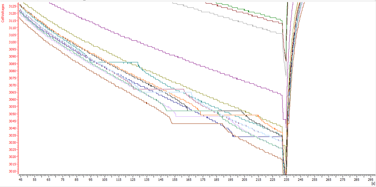

Hi David,
Here is the chart representing end of discharge of our battery pack 14S16P, based on BQ76940.
In some period of time cells voltage is almost stable (do not changing lineary).
The VCx error is not linear. Is it posibble that not linear VCx error is causing such behavior of cells voltages measurements?
