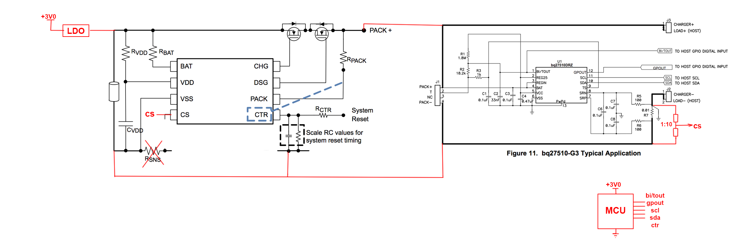

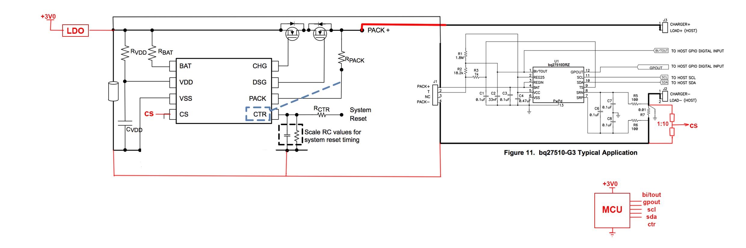

Hello!
While developing BMS for 1S cell using bq2980+bq27510+mcu I've noticed that bq2980 measures shunt voltage the opposite way compared to bq27510 and that I actually need 2 shunts (1mR for protection and 10mR for gauge). So I'm wondering if the schematic below will work or not?
P.S. Cell is not removable.
