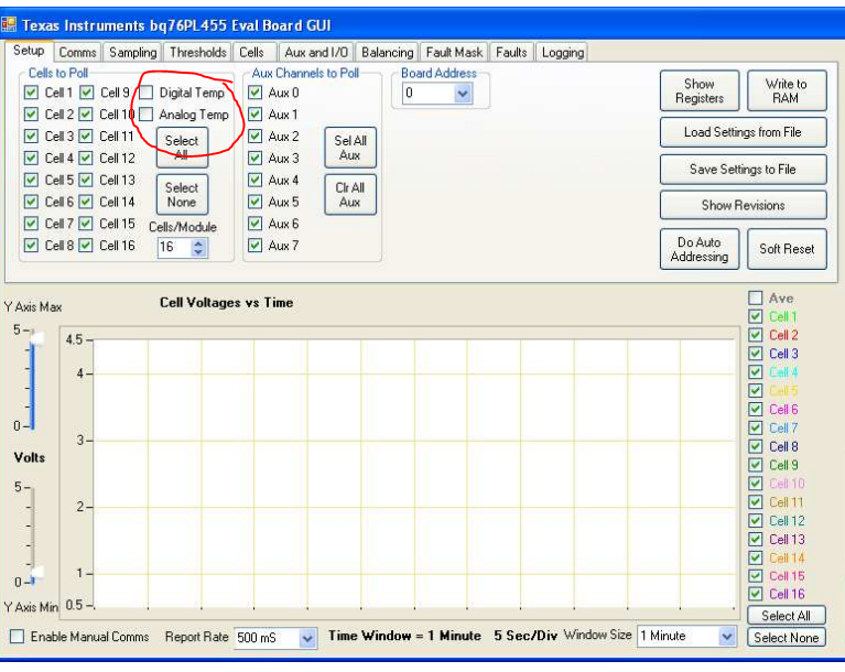

    just confirmed with RD that their problem has not been solved? The customer said that the situation they encountered was that the temperature measurement was not accurate. Temperature measurement on the customer's own PCBA. Use TI's GUI to measure the customer's PCBA. The room temperature is 27 degrees C but the PL455A returns is 42 degrees C. Whether it is Digital Temp or Analog Temp. Excuse me, where is the customer's inspection?

  • the temp measurement of the anlaog-die is programmable as part of the ADC seq. SET CHANNELS[CMD_HTSEL] The report value is the voltage from temp sensor, NOt the actual temp. Use VADC = [2 * VREF/65535] * READ_ADC_VALUE.

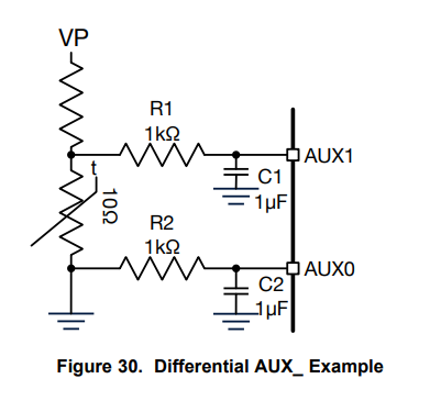

    Confirm with the customer this morning whether the problem is solved. The customer follows the NTC connection on the DETASHEET of BMS 455.
    There is no way to measure the required temperature message. How can I modify it?
    The customer tried to connect the NTC to the PL455A Vref pin and found that the correct problem could be measured. The customer wants to connect to the NTC using VREF.
    There is no VREF Iout written in the datasheet. How much current can be supplied from the IC VREF of the PL455?

  • Hello Vish,
    The key point is that the customer can't connect VREF, and then DATASHEET tells us that the following Fig 30 connection can be accurately measured, but the customer can't get the similar value according to the following formula. What should the customer debug direction do? Would you please help the revew circuit diagram? Can I email the customer's circuit diagram to you? The customer now uses the GUI to read the temperature. How can I read the scratchpad Read_ADC_value?

  • INT_TEMP is fixed; its not for sensing cell temperatures.
    Digital die temp can be measured via the ADC by setting CHANNEL[CMD_TSEL] bit.IN
    the conversion formula Internal Die temp is given by the equation (4) in the same section.
    INT_OT_THRES. Is written at test in the register address x550-x551 in the EEPROM.
    If the internal temp exceeds this value, INT_TEMP_FAULT will be set.
    The internal register is being set @ 0xAB68.  In decimal, 43889
    5V full scale is, 0xFFFFà65535 ; so 0xAB68,
    VADC = (43889/65535)* 5V = 3.3478V…
    From d/s equation #4,
    INT DIE temp C = (3.3478-2.287) *131.944 =139.9C……..
