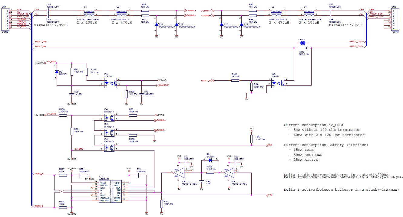

  • Below relevant parts of the schematic.
    We intend to put the battery controller into shutdown during storage and shipment. So we need a way to wake up the battery.
    The problem is in the part that when starting the communication, the battery management IC goes into shutdown (unless we keep the Wakeup input high until it recognized the number of devices present in the TI GUI). After that we can make wakeup low and it keeps working)

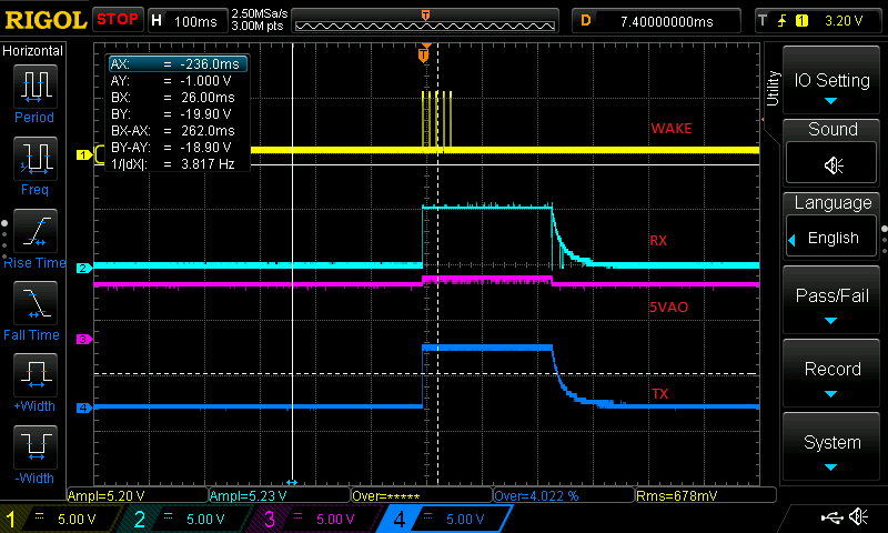

    Sorry my attachment of the scope captures did not come thru the first time.
    Sounds like your part is getting wake pulse..below Fig#1confirms, but the device should not shut down..please confirm, if the WAKE pulse is one burst on the base device.  and the v5vAO is up...also on fig #2here is the sequence of the regulators and the
    important Charge function after the WAKE.
    The problem, seems, the device is not receiving a clean wake burst. refer to the d/s exactly pulse width that needed.
    92) What is the STACK voltage?
    FIG #1
    FIG #2

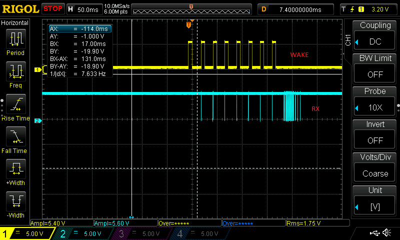

  • Hi Vish,
    I have made some scope pictures:
    Above looks all OK to me. (Slopes at wake up are a bit different compared to your picture.)
    We use a 50V stack voltage.
    Below the picture with the wake up againt the RX Pin (in total) Also 5VAO in this picture.
    From this picture I zoomed to the first and the last part in below pictures:
    In the last picture you can see that after receiving the first communication the battery controller goes into shutdown with the resukt no more communication possible. I checked the normal behaviour of the GUI. It normally send up to seven times the same byte to the battery controller. after that some other data is send.
    If i force WAKE to be high during the first part of communication with the GUI (until it detects the number of boards) and the make it low again. I can communicate with the battery controller without a problem.
    I have tried this on more than one board.

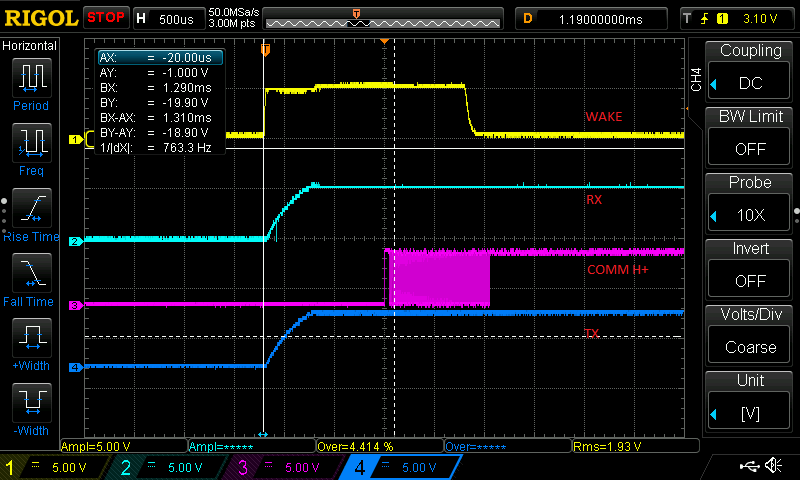

  • Hi Vince,
    Point 1 I know I get wake signal on the differential bus to the next part I already checked that.
    Point 2 With the 5 pulses it is still not able to communicate (I even increased to 100 pulses but had the same result)
    I still have the same behaviour. I believe the battery management IC is awake. But it receives something on which it decides to sleep. If we keep the wake pin high during the initilization of the gui and then make it low the communication will work until we press the button reinit serial comm. After this the IC is in sleep again.
    I have tried to reproduce this problem on the 76PL455EVM. I partly succeeded in reproducing. If you remove the connection to pin6 of J3 (wake from the FTDI) you will never be able to communicate with the BMS ?????. The difference between this and our own board is that our own board goes into shutdown after receiving the first byte. The EVM stays awake.
    Below is measurement on the EVM (with Pin6 of J3 still connected)
    I have seen on the EVM that whenever there is an wakeup pulse, a byte is received, and then the next wake pulse (this repeats for a number of times) and then the communication starts. There seems to be a relation between Wake up and the byte received. (It this true?). The datasheet does not mention any relation between wake and RX. It also does not mention you need to send more then 1 wake up pulse!

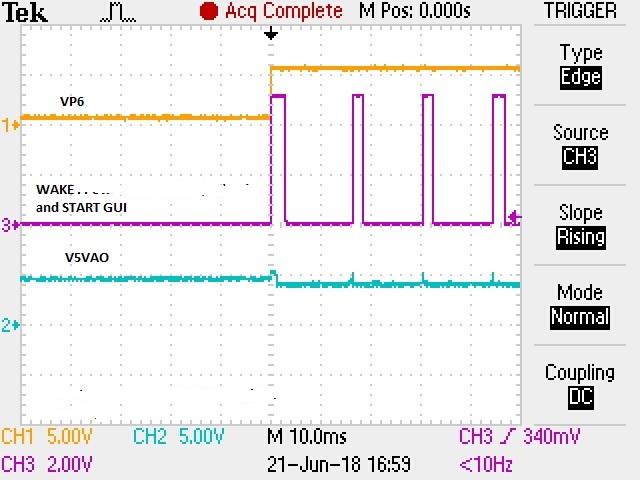

  • Hi Vince,
    I have tested again with the EVM.
    This time i disconnected Pin6 of J3 from the FTDI, but i put a pullup from pin 3(VCC) to Pin6 (WAKE).
    If i do this the wakeup pin is defined as zero. After powerin the board i manually give a pulse on the wake pin (a short between pin 1 and pin 6). After verifying the board is awake (measuring VP1) I tried starting the GUI. This gives exactly the same result as on our own board. The communication will not start and the battery chip goes into sleep.
    So the EVM does exactly the same thing as our board!?.
    So my issue is not fixed yet. There is something very specific which is needed during the starting of the serial communication. (To remind you if we tie the wakeup pin high, the communication is always starting. But we cannot put the chip into sleep).
    So additional hints, idea's to test are welcome.
