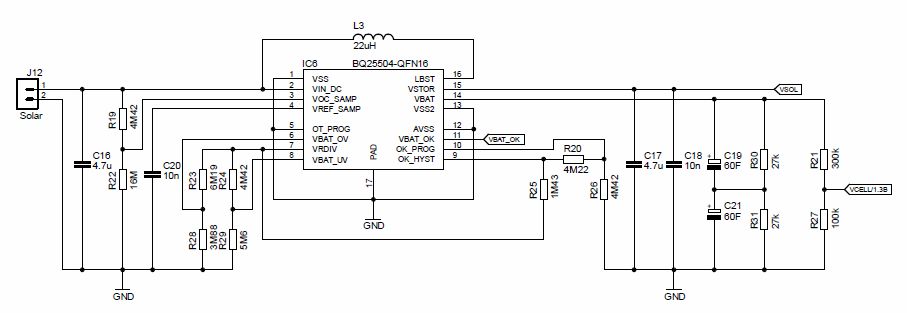

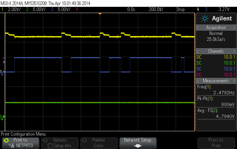

I'd like to ask for help. I have an issue with BQ25504 circuit with supercaps. When VIN_DC reach the programed Vbat_OV level then Vbat_OK signal drops down for a short time and then goes back. That causes load power failure because I am using Vbat_OK signal to controlling DC/DC converter by enable pin.
I am attaching the scope figure (blue – Vbat_OK signal; green Vstor) and the schematic.
Thank you for your help
Michal
  • Hello Michal,
    Could you take the same scope shot but also include the VBAT signal?
    Also have you noticed if the changes on VSTOR are related to some other component in your system? They three deviations that you should do not seem to have consistent timing so I am curious if anything in your system could be running on a similar timing scheme.

    thank you very much for your answers and tips. Unfortunately, it did not solve the issue. I perform another testing. I this case, a static load (resistor aprox. 500 OHM) is connected directly to supercaps as Jeff suggest. When Vbat reaches overvolage level then Vbat_OK starts oscillating in the same way as current from harvesting source (in my case: Agilent power source – 2.8V constant voltage). Also, the circuit behaves this way with or without any load. I am attaching a new figure.
    Vstor (yellow), Vbat_OK (green), Vbat (blue)
    Vstor never drops under undervoltage level and then I do not understand the reason why Vbat_OK signal is still dropping. Vbat stays always constant. Is it possible that BQ25504 is not able to charge such large supercaps (two 60F in series) due to its internal resistance?

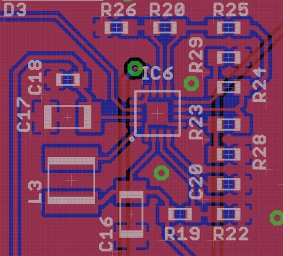

  • The board is professionally manufactured and well cleaned. I tested 4 boards and they behave same way. Maybe I failed on layout level (thin connection between Cstor-C17, Inductor-L3 and IC6).
    I will try change resistors values first and then I have to change the layout.

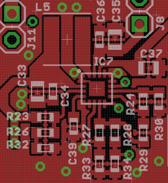

  • Good new everyone!
    I solved the problem with Vbat_ok dropping. My devices now have new 4-layer PCB design. I am attaching the top layer as a reference. Mainly, I used PCB polygon to connect inductors and I optimized other layout. The Vbat_ok signal is now stable at fully charge and the problem is fixed.
