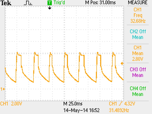

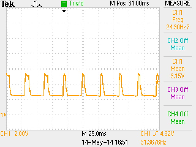

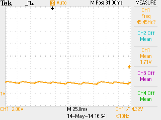

  • Hi Rachel,
    Below the waveforms:
    ACDRV:
    BATDRV:
    SW:
    REGN:
    I'm trying to start-up it with no battery connected but with a 10k resistor assembled in R111 position. As load I have a switched regulator in the output (PWR_IN) to 5V and I'm using an 8 ohms resistor in this output, so the total load consumes around  3W. Maybe I will need around 5W with all board connected.

  • Henrique,
    It would be better to have a scope plot with both ACDRV and BATDRV on it, but It looks like something is causing the IC to switch the power path selection from VIN to BAT and back.  I'm wondering if there is a leakage path from system to battery?
    If you can look at BATDRV, ACDRV, AVCC and SRN on the same plot, do you see if maybe the sleep comparator is being triggered (SRN voltage approaches AVCC voltage)?  You would see SRN rise until ACDRV and BATFET switch and then SRN voltage would fall until the FET drivers switch again and recharge SRN.

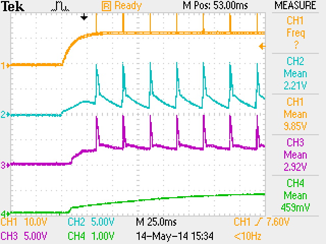

  • Rachel,
    Below the waveform with the signals:
    CH1 = BATDRV; CH2 = ACDRV; CH3 = AVCC; CH4 = SRN.
    These waveforms were captured with no load in the PVCC and Vinput = 12.9V.
    Notice that the SRN signal is very low level and don't get the level of ACDRV or AVCC.
    Below I got the waveforms with 8 ohms load in PVCC.
    I inserted the cursors to help in reading the levels.
    As you did, I also can't see any leakage path in the circuit.
    Henrique.

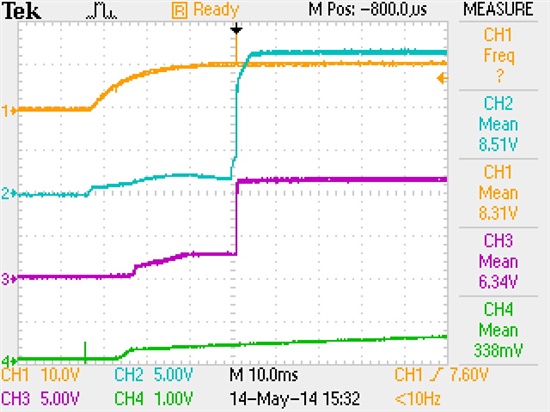

  • Rachel,
    I've captured waveforms of start-up.
    For the waveforms below we have:
    CH1 = AVCC; CH2: ACDRV; CH3 = BATDRV; CH4 = SRN.
    First with 11.5V at input:
    And then with 13V at input:
    Henrique.
  • Hi Henrique,
    Thanks for the detailed captures! It looks like OVP is being triggered (spike on AVCC).
    I believe that you should remove CR9 to resolve the problem.  Reverse blocking protection is provided by Q16 so CR9 shouldn't be needed anyway.
    Let me know if this helps!
    Rachel

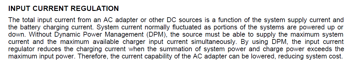

  • Hi Henrique,
    The ACSET pin doesn't actually limit the current going to the system but rather it sets the total current for Battery Charging Current + System Current.  This will allow you to have an adapter with a relatively smaller current capability and the IC will dynamically adjust/reduce the charging current to ensure the system is fully supported during periods of peak power draw.  In effect, it only will reduce the charging current and will not attempt to restrict the system current.
    The reasoning behind this is that if the IC were to limit the system current it would immediately kill/brown out the system. However, by allowing the system to continue to pull more current, the adapter may be able to support this for a short time and the peak power load of the system might pass before the adapter voltage drops and kills the system.
    The assumption is that the user will adjust the ACSET limit to be just safely under the current capability of their adapter and that their maximum system load should be less than this, or the adapter will not be able to support the system.  In a practical sense, your typical system load + fast charge current (ISET) should be less than or equal to the current your adapter can provide or your battery will charge slowly.
    The Bq24172 datasheet on page 19 describes the function as follows:
    Please let me know if this explanation helps, or if you still have questions or concerns about the DPM function.
    Rachel
